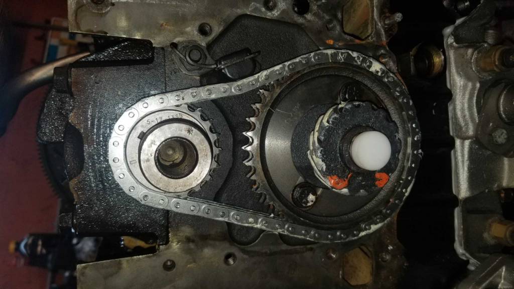

should I leave the timing chain tensioner on or not
natedog910
Apr 7, 2015
been doing some reading so some say never had a problem and others not so good?
Sent from my SM-N950U using Tapatalk

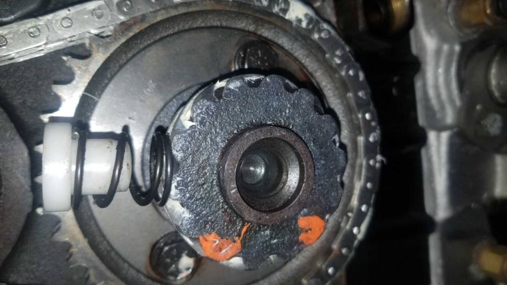

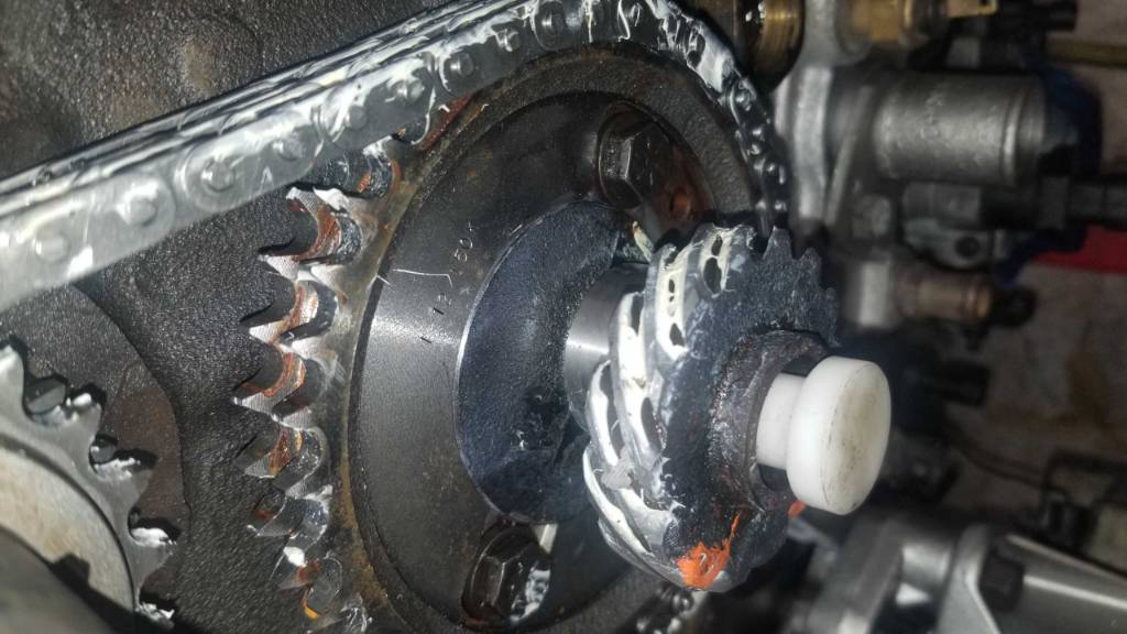

not liking this cam button either ,it was just stuck with spring compress when I took off timing cover?[emoji848]
If your running a double roller Chain and gears ...LEAVE IT OFF!!! My builder left it on and it eventually tore up my timing cover and was not pretty...Cost me $$thousands in rebuild costs.....Had I know it was on there from the start i would have taken the tming cover off and removed it myself. LIVE AND LEARN......LEAVE IT OFF....TRUST ME!
next question is this correct, I bought cam button at local hp dealer he said ,just use cam button no spring?
Don’t listen to him unless you have DEEP pockets, throw away that plastic POS cam button and get one with bearings, Nick micale, Steve V, Bison, Mr. Clark, Lorenz racing, Cottons, Weber, and a few more builders that I know I am forgetting can’t be wrong.
You need to use the spring, but that plastic is going to wear out fast, and then your going to be in rebuilders heaven.
You have it apart, buy the correct cam button from one of the vendors, do it correctly the 1st time.

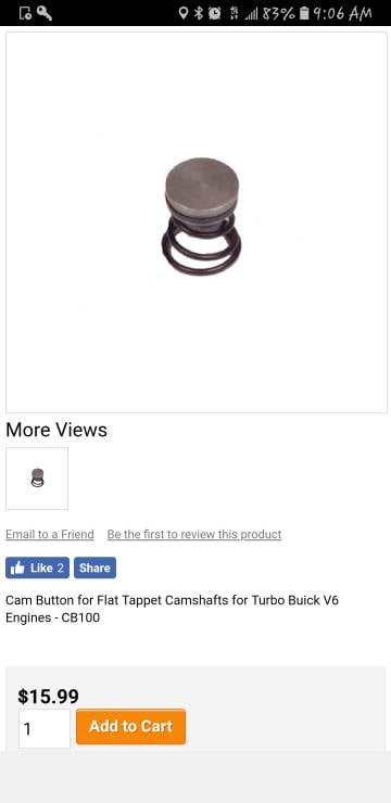

Agreed . If running stock style chain use the tensioner. If using a double roller chain pitch it. Also don't use that plastic button. Get a roller cam button Melling number #CB100.
