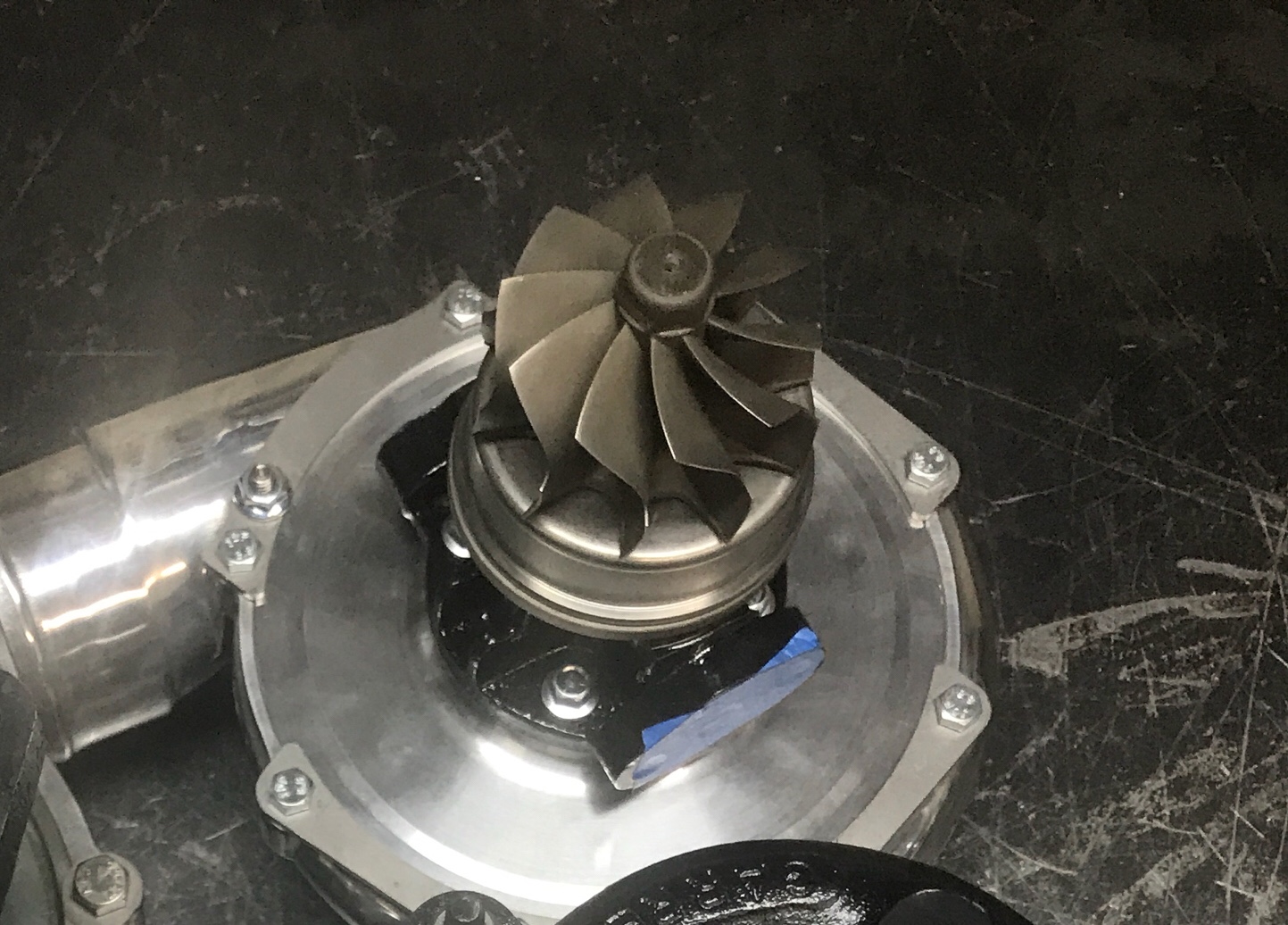

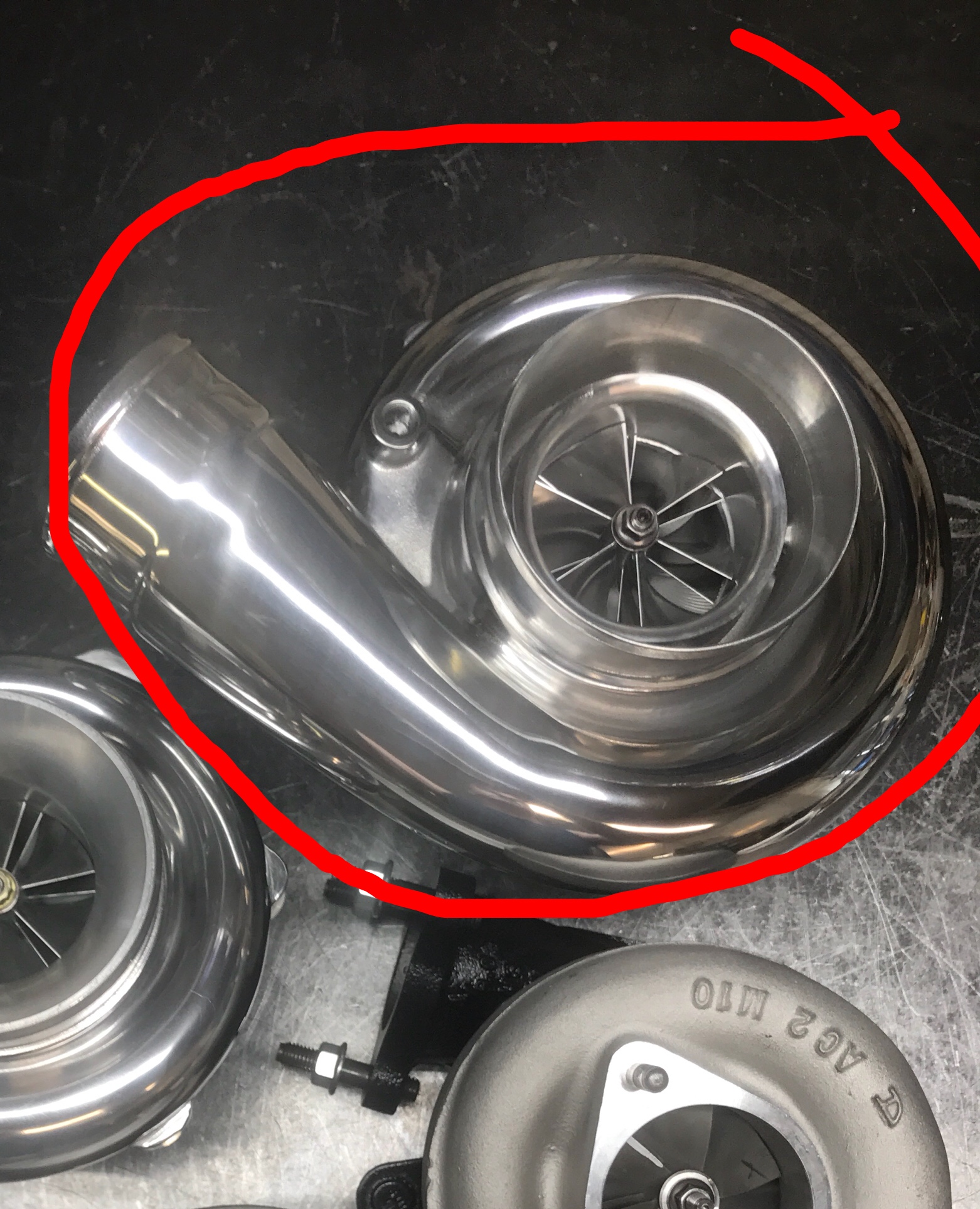

This is my response to a TE45a. It's an MFS 6766. It will outperform a 45a in every way. It's not even close. 90lbs/min. Low 9 sec potential. I'd put it against anything with a smaller compressor.
