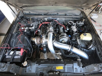

Its been a busy year with the GN, started with a dyno session last fall. The tuner I went to took a lot of time with the car making it very drivable when cold and hot, it drives perfect, no stumble, starts easy when cold and hot, tip-in is perfect, all good. He did find the turbos were too big, I suspected they were and this confirmed it. I wasn't sure if the big port S2 heads were causing it to lag or the turbos, it took too much rpm to get them to spool, 3 cylinders were not enough to spin S300s. It did make almost 700rwhp @ 6500rpm, a couple hundred off what it should make and not as fun to drive as I thought it should be.
So I sold the S300s and installed BW 7163 EFR turbos last winter:
These turbos solved the problem, these start to spool around 2500 and come in hard/fast, the engine has now come alive, the trans also bangs much harder even at light throttle. The EFR turbos have aluminum cores and weigh-in 12lbs lighter (each) than the S300s, they are water cooled so a bit more plumbing was required. The physical size is much smaller and the light weight made them pretty easy to install, just had to add about an inch to each downpipe which was easy.

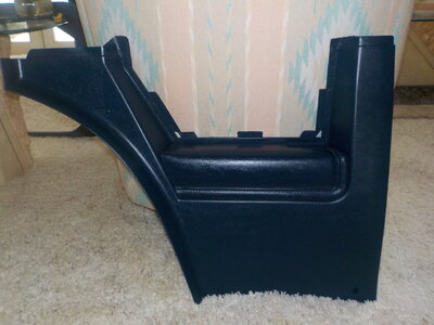

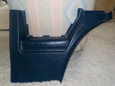

Also installed the new center console after I had a body shop paint it and I put in a much better street shifter. I built a new stereo system, I couldn't see the old stereo display very well and the tiny factory speakers just couldn't cut it. Had to sell the racing seat as it was too uncomfortable, the Braum seats I installed last fall get a 5 star rating from me, very nice seats.

Couple of pics, both EFR turbos, then a side by side size comparison with the old S300. The S300 would be good as a single turbo for a V6, not so good as a twin setup. The EFR turbo wheel is the last pic. These EFRs are much smaller and waay lighter, these have a T3 inlet, 2.5" outlet, 3" V-band exhaust outlet, 0.82 exhaust A/R and a 3" air inlet (company in CA sells them with these specific features). The old S300s had a 4" inlet, 3" outlet, 0.70 exhaust A/R, 3" V-band (different type of V-band) exhaust. The 7163s flow enough for over 1k hp at approx. 28psi.

Looking back at these pics I remember all I had to do was cut off the V-bands and install the ones that fit the EFR housings, I didn't have to add any material to the downpipes. After running the car for a while now I can say the header coating was a waste of money, I have had to wrap everything as the radiant heat is wicked underhood. The exhaust wrap works very well, 100% better than any coating. Plumbed the turbo oil feeds from the back of the block with the oil pressure sensor and the oil filter adapter. Took some creative plumbing to get the water in and out.

Plumbing and blankets. I found the best thermostat housings have the threaded features after the thermostat, not in a giant spacer before/under the thermostat. Both water returns are in the heater lines, the water feeds are from the intake/T-stat housing.

Have to pre-lube the turbos before starting the first time. I had to remake the passenger's side WG exhaust, the meth. tank was getting too hot from the pipe being too close. Any split loom near (within 10 inches) the pass. side header was melting, even though its high-temp. stuff, the radiant heat from the headers is brutal hot.

The new gauge measures crankcase pressure, so far its been under 2psi, no vacuum pump (no room anyways). The paint shop did an outstanding job painting the console, the piece that fits over the shifter is painted GN grey. In the trunk I placed the power grid for the amps and the front crossovers. The Pioneer head unit has a 7" pop-up screen and has Apple carplay so I can view Pandora and Waze which is what I use all the time.
