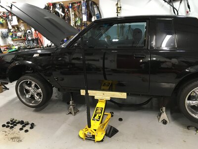

Chassis strengthening is now on my mind. What I need; I want to jack the car up from any corner and have the whole side of the car raise up evenly......stiff chassis is what I want. How can the car be stiffened greatly with the least amount of difficulty?
- 6-point cage (seems simple, I'd let a professional shop do it)
- Welding frame shut with Hellwig kit and add reinforcement bars (really difficult: remove body from frame)
- Cage and frame work?
The car is a flimsy noodle as it sits, have to get rid of the quarter panel folding inward.

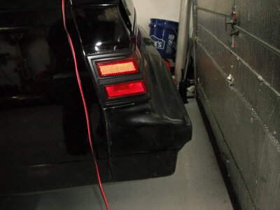

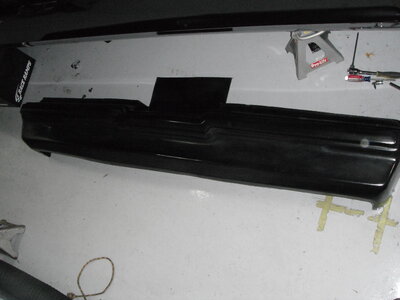

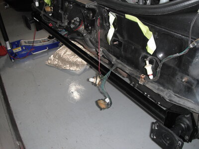

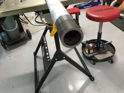

Winter projects on the GN: Installed 1-piece Featherlite rear bumper, GNS rear frame brace, UMI shock tower brace & replaced all the body bushings with Kirban stock-style units. Used a thick-walled tube for frame brace.
Mike

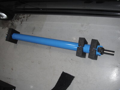

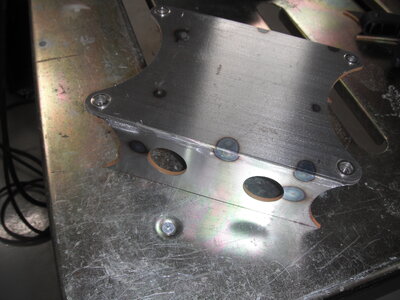

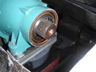

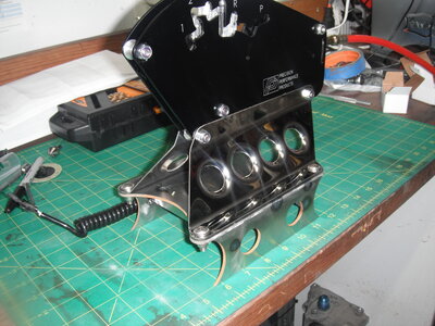

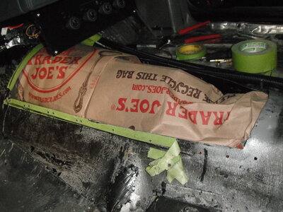

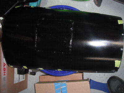

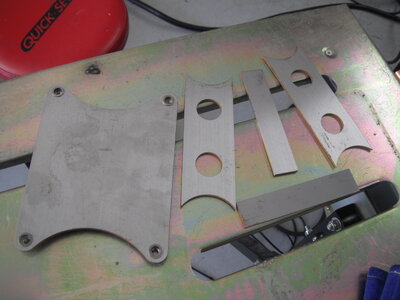

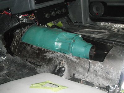

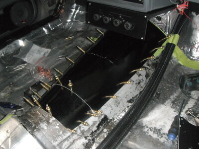

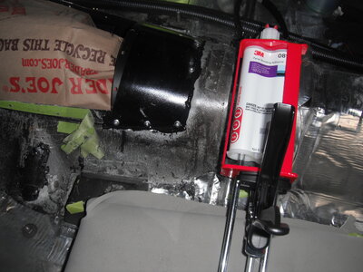

Winter projects con't: I found the driveline angle was off, so I had to raise the trans tail quite a bit to get it to 2.5-3 degrees. The trans tunnel had to be cut out and a Hurst tunnel bonded in its place. It was a good opportunity to build a new soild shifter mount.

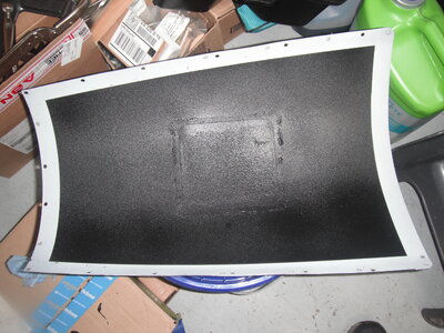

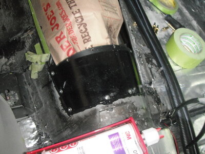

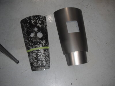

Tunnel work, Hurst tunnel comes in 2 pieces. I welded the 6 speed hole then primed and painted before using 3M panel epoxy & rivets to bond it to the floor. The angle change meant I could no longer fit my 4" diameter driveshaft in without hitting the floor so I went with a 3.5" Mark Williams shaft and it fit perfect.

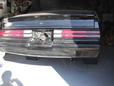

I'd like to see a little more of that rear bumper. Can you shoot a few more pics? How does it fir under the taillights? At the quarter panels? Can the imitation impact strip be chopped down, filled and made smooth?

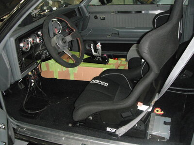

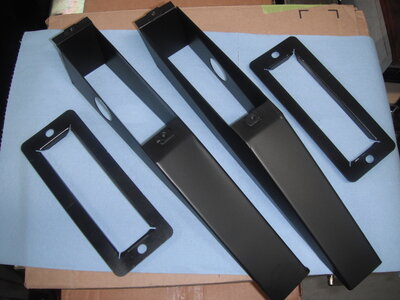

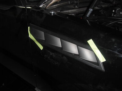

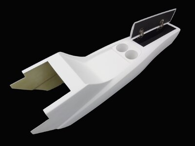

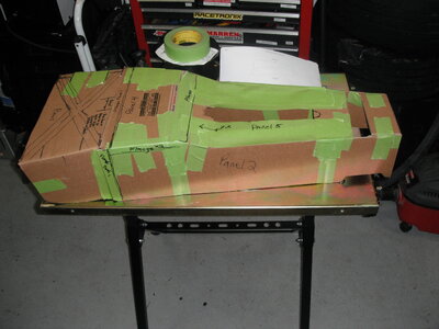

Winter projects con't, tried to design a console but went with a pre-made fiberglass unit that is very close to what will work in a GN, waiting for it to arrive. Finally got around to installing my GNX fender vents:
DSCF2909.JPGDSCF1891.JPGDSCF1895.JPG1002.jpgDSCF2896.JPGDSCF2903 (2).JPGDSCF2902 (1).JPG

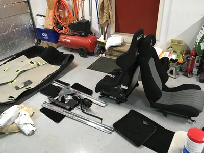

Summer projects: New design ATS steering arms, Vibrant resonators, Braum seats, Ridetech front sway bar, UMI rear sway bar, Global West front LCA, fitted new console. A word about FAST XFI, the upfront purchase price is only the beginning, it will cost you 3x on top of that to get it right. No over the phone tune is going to dial it in, it takes a pro to do this on a dyno or by your side at the race track. Be prepared to pay the man, not to View attachment View attachment View attachment View attachment View attachment View attachment View attachment simply provide a quickie-tune for WOT and to get the engine started but to tune it so it works very well everywhere in the rpm band and starts perfectly at any temperature, that will cost you.
