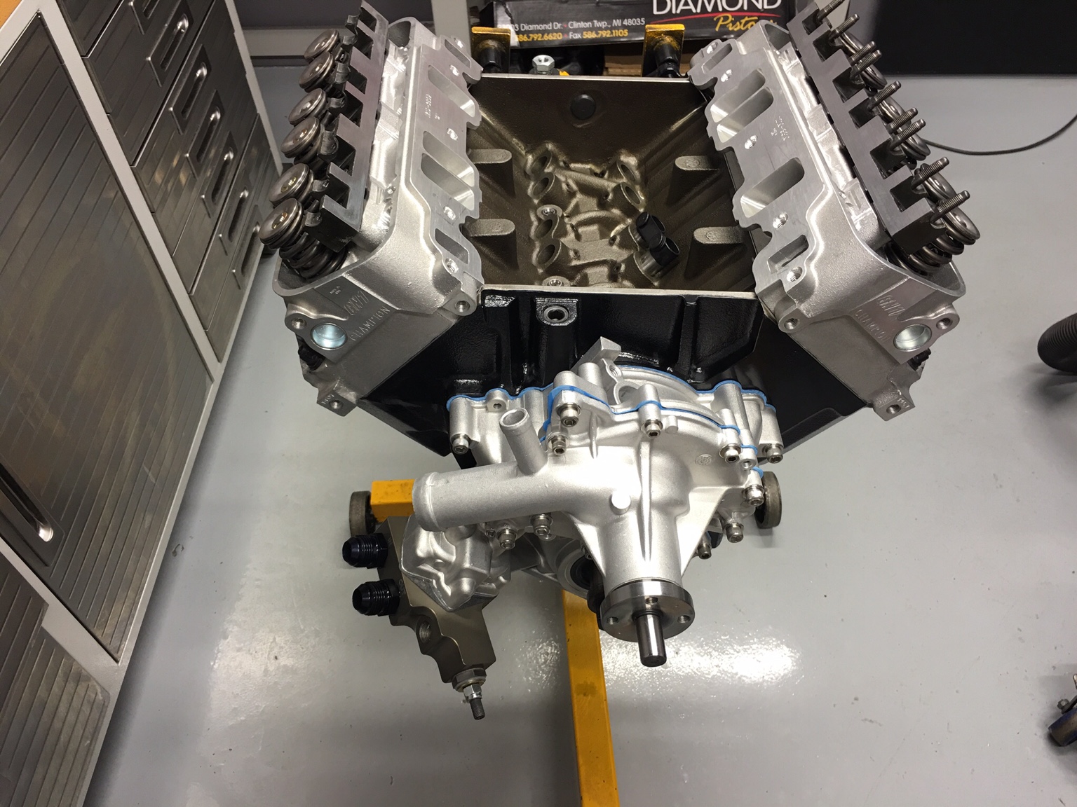

My Stage 2 Off-Center build is just about complete, this is a Twisted 6 - Hogeland build. Just waiting on the ATI Super Damper, pushrods and some fittings to wrap it up.
Here are some of the specs:
- 275ci (4.015 Bore - 3.625 Stroke)
- CP Pistons (9.5-1 comp)
- Oliver Speedway Billet I- Beam Rods
- Cryoed forged stroker crank
- Champion GN1 aluminum heads & intake
(Fully ported by Hogeland - raised runners)
- Custom hydraulic roller cam

Wow, that looks like perfection, what trans are you going to use?
Mike
Thanks Mike, I will be switching over from a 200r4 to a Lonnie Diers 4l80e with his new manual valve body and trans-brake. The converter will be a PTC 9.5" NLU.

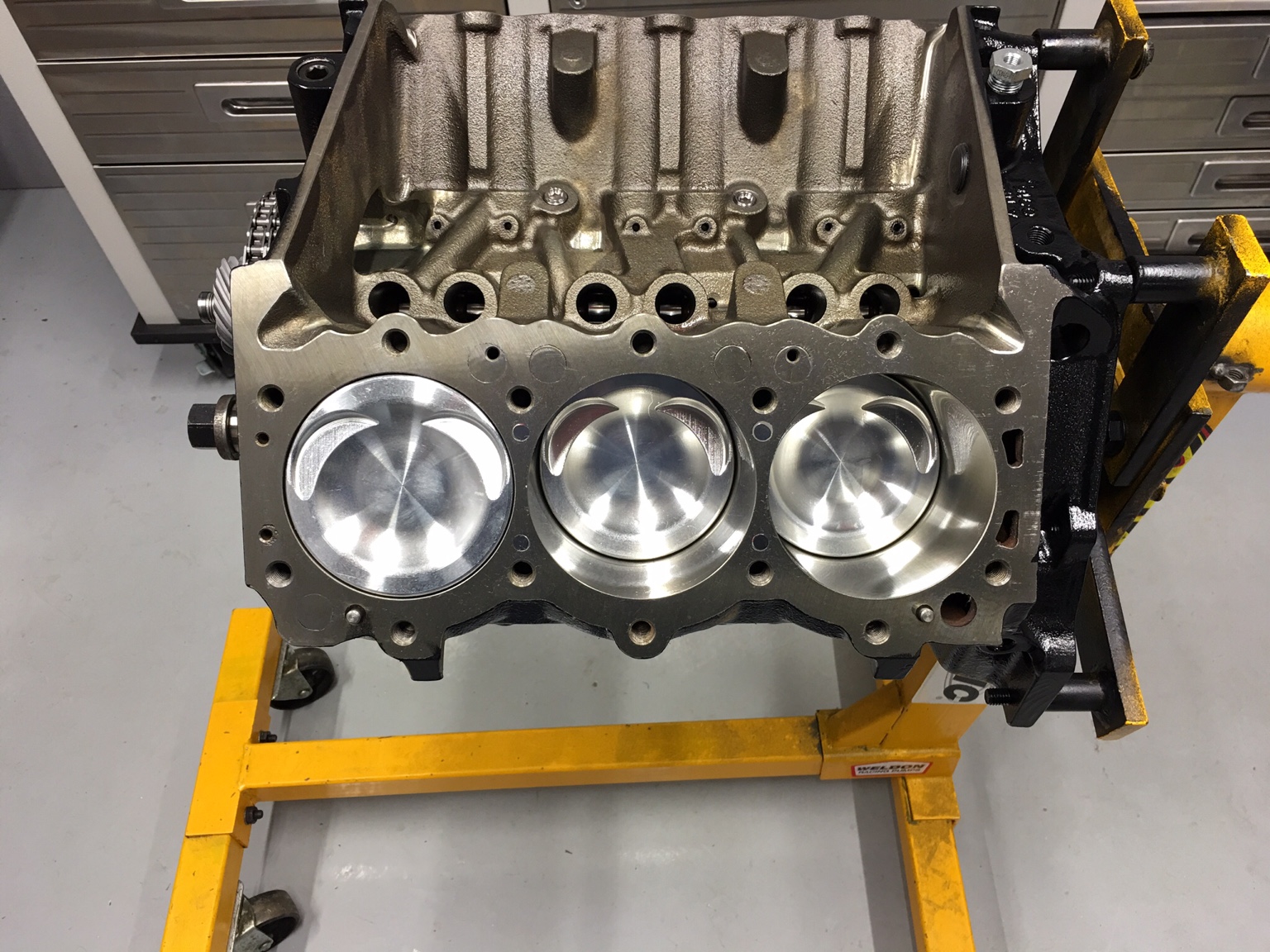

my first stage motor built.
012 block
BMS crank, oliver rods, wiseco pistons
BGC off center intake
M&A fully race heads
blah blah blah.
012 block
blah blah blah.View attachment 278456 View attachment 278457 View attachment 278457 View attachment 278457 View attachment 278458 View attachment 278456View attachment 278457
