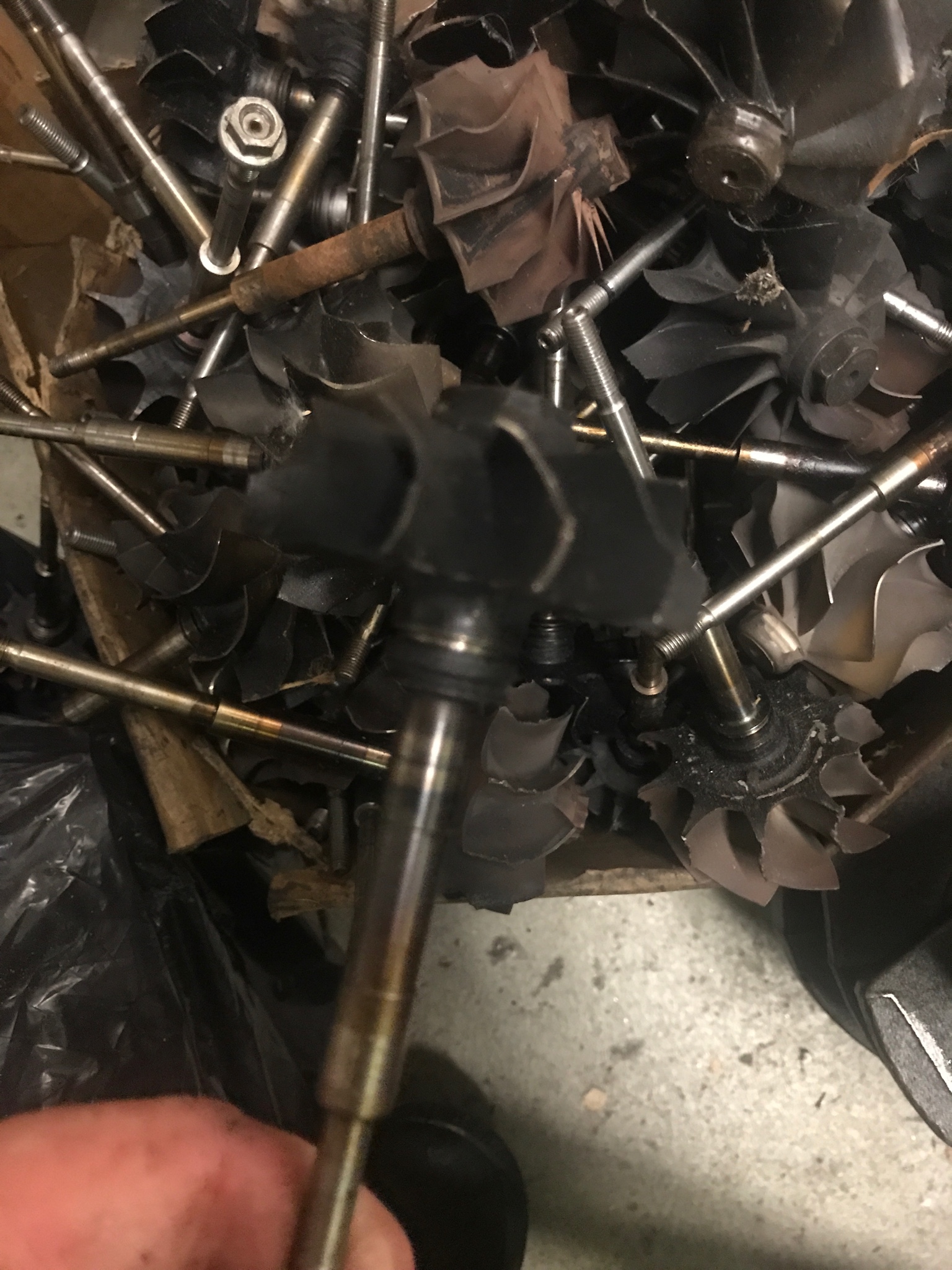

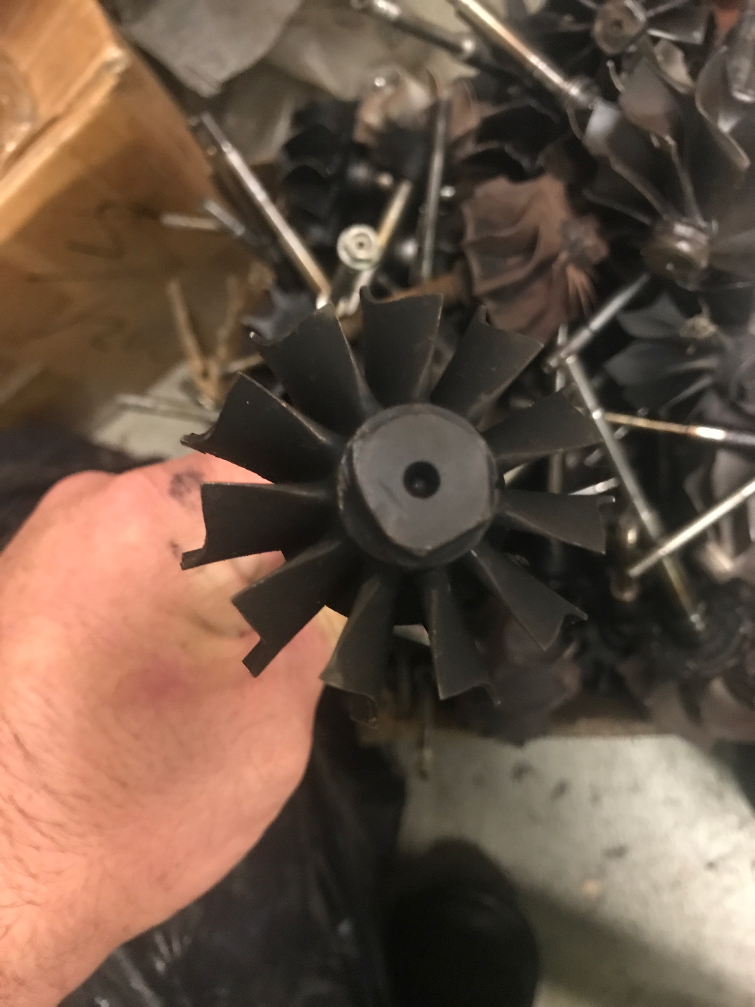

if the goal is to see how far the stock turbo can go, you can have the exhaust wheel clipped. And perhaps extrude-hone the exhaust housing.
Bob
There isn't much to clip on the stock turbine. It's like a paddle wheel as it is. Almost no exducer
ahh, gotcha, I haven't looked at one in a long time... I do have that stocker I need to send your way, maybe I should put it on the car and see how hard I can spin it..... :)
Expensive scrap
