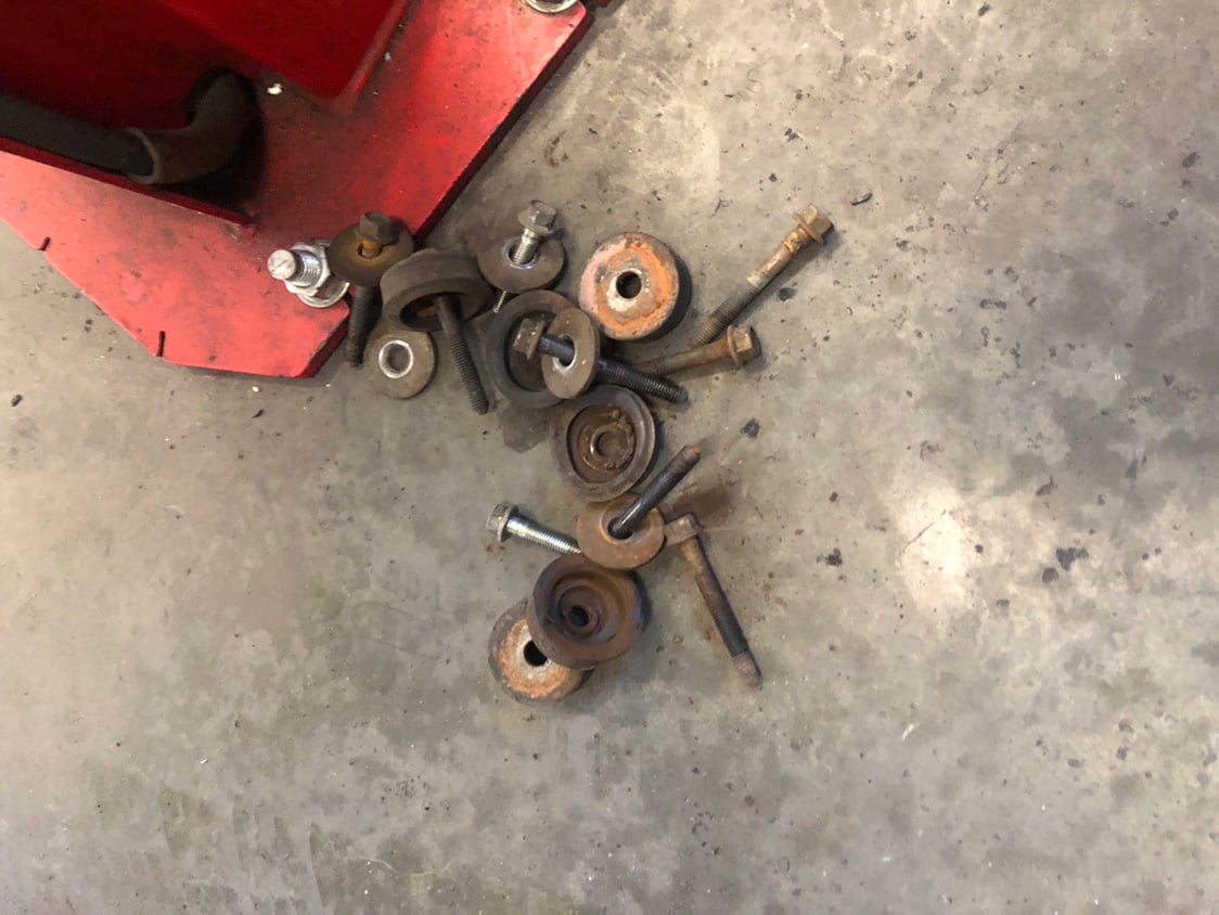

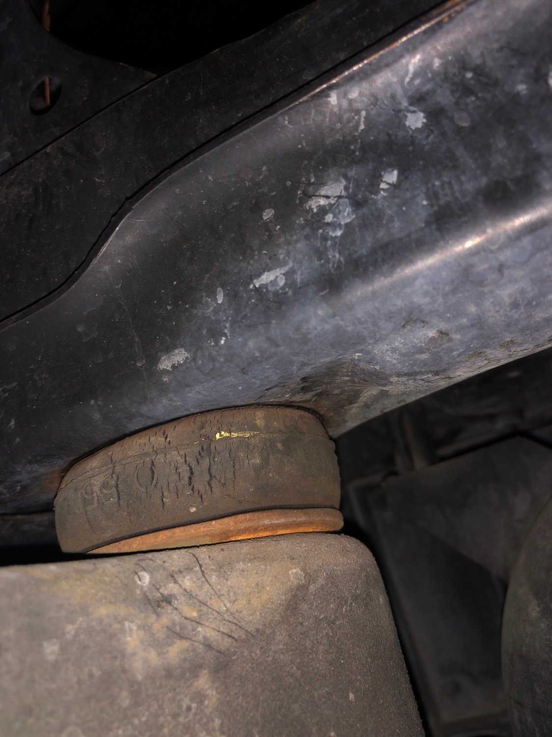

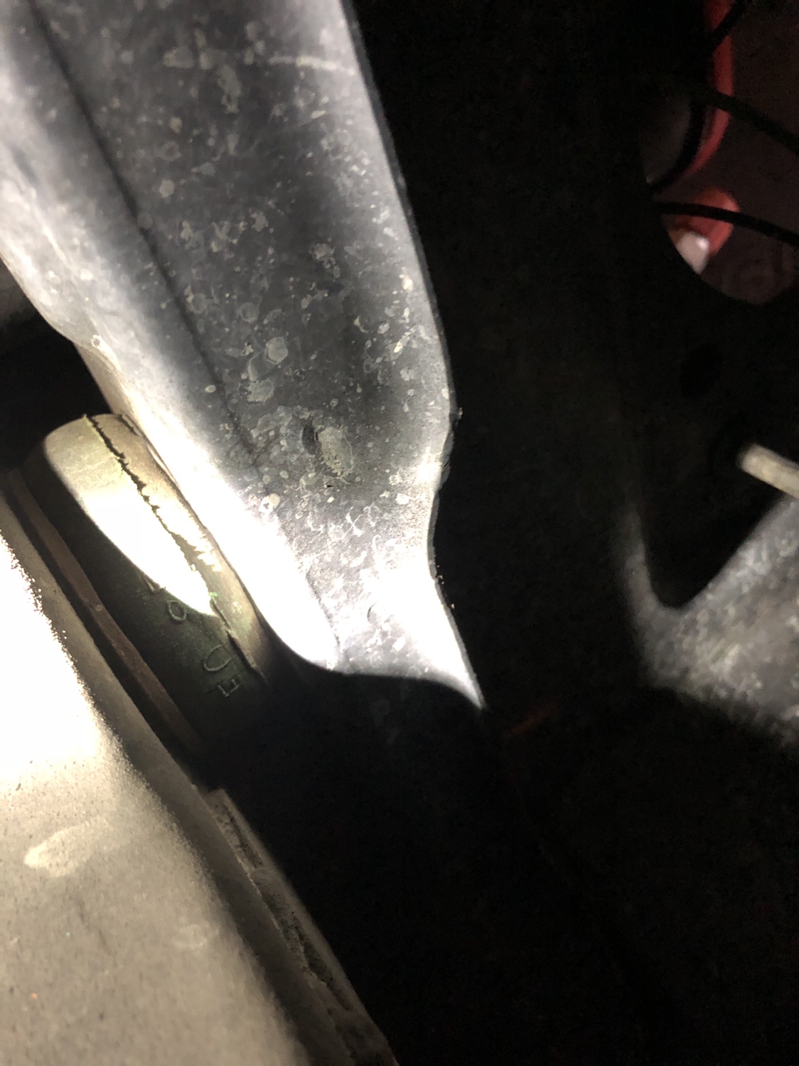

My problem exactly. My Dr side wheel sits inside the wheel well almost an inch more than the Pass. side... I was thinking that the front fenders were misaligned. But I've checked the gaps, done some measuring... I have not changed the body bushings. I think I have the same issue.
