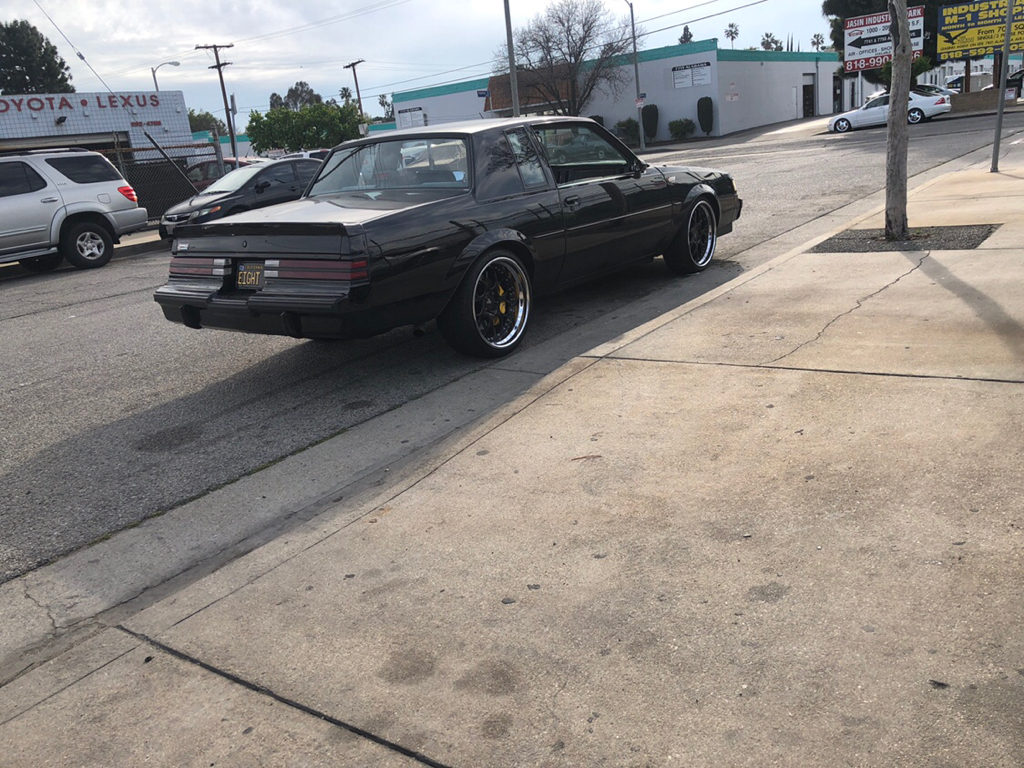

Doing the body bushings eliminated the rattles and raised the front a bit , so no more rubbing on the top of the fender, hit the usual bumps on the ride back home and didnt hit , passenger side tire went inside the fender well a bit more and now is barely noticeable that its slightly off.
Ended up adding the front brace, rear strut brace and 1” rear sway bar which made the biggest difference of all.
I am about to install the control arm braces . And a slightly taller sidewall tire along with rear coilovers just to complete the set.
Here is what ended up like
