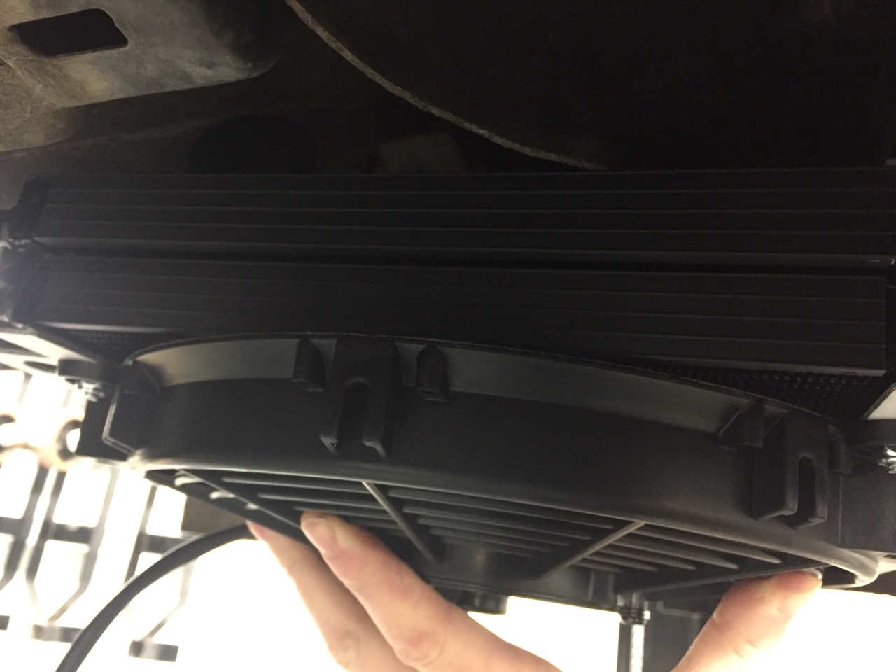

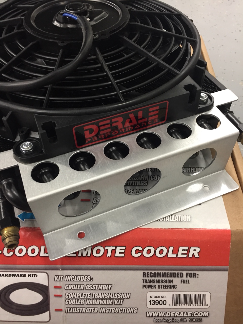

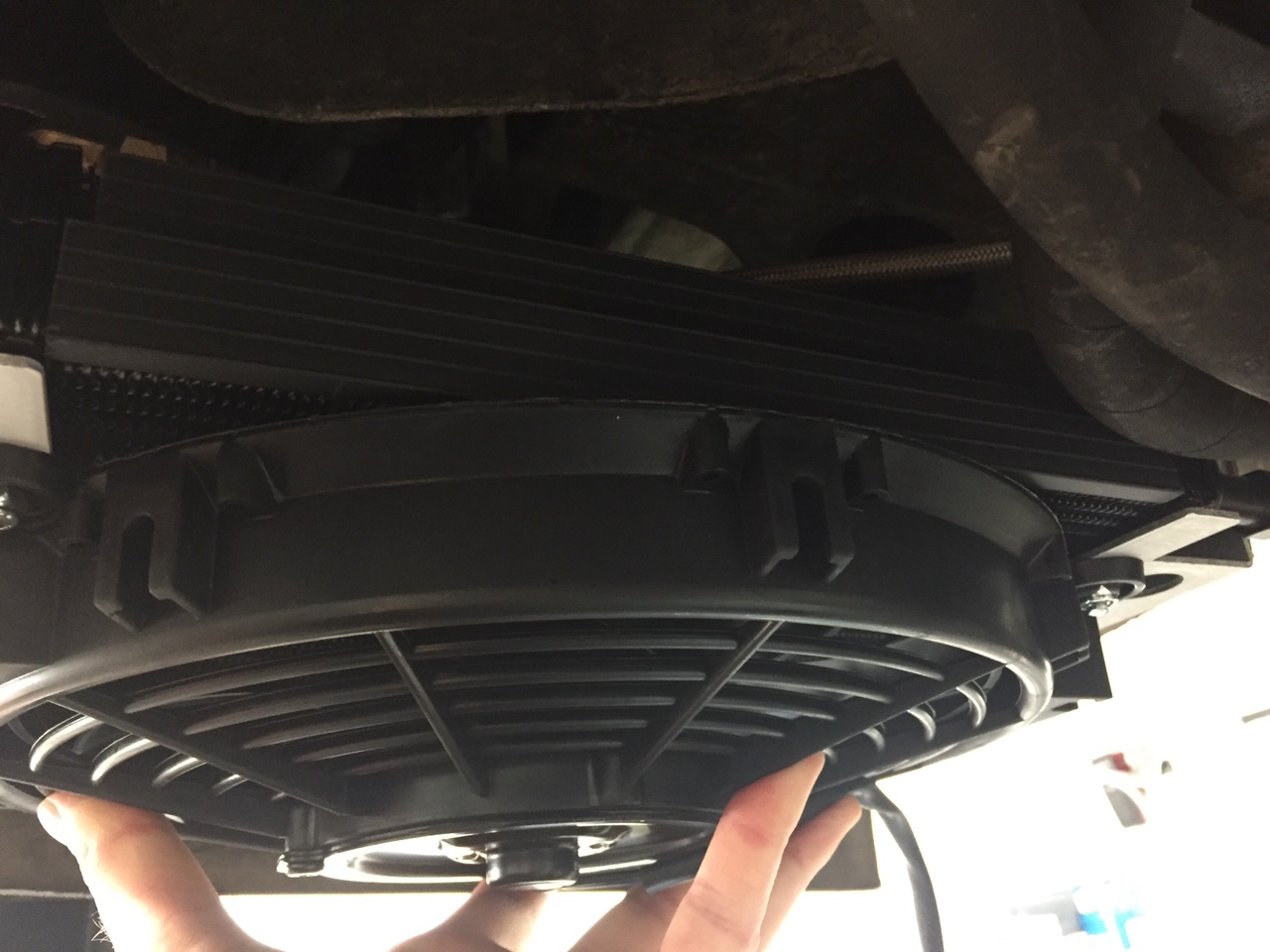

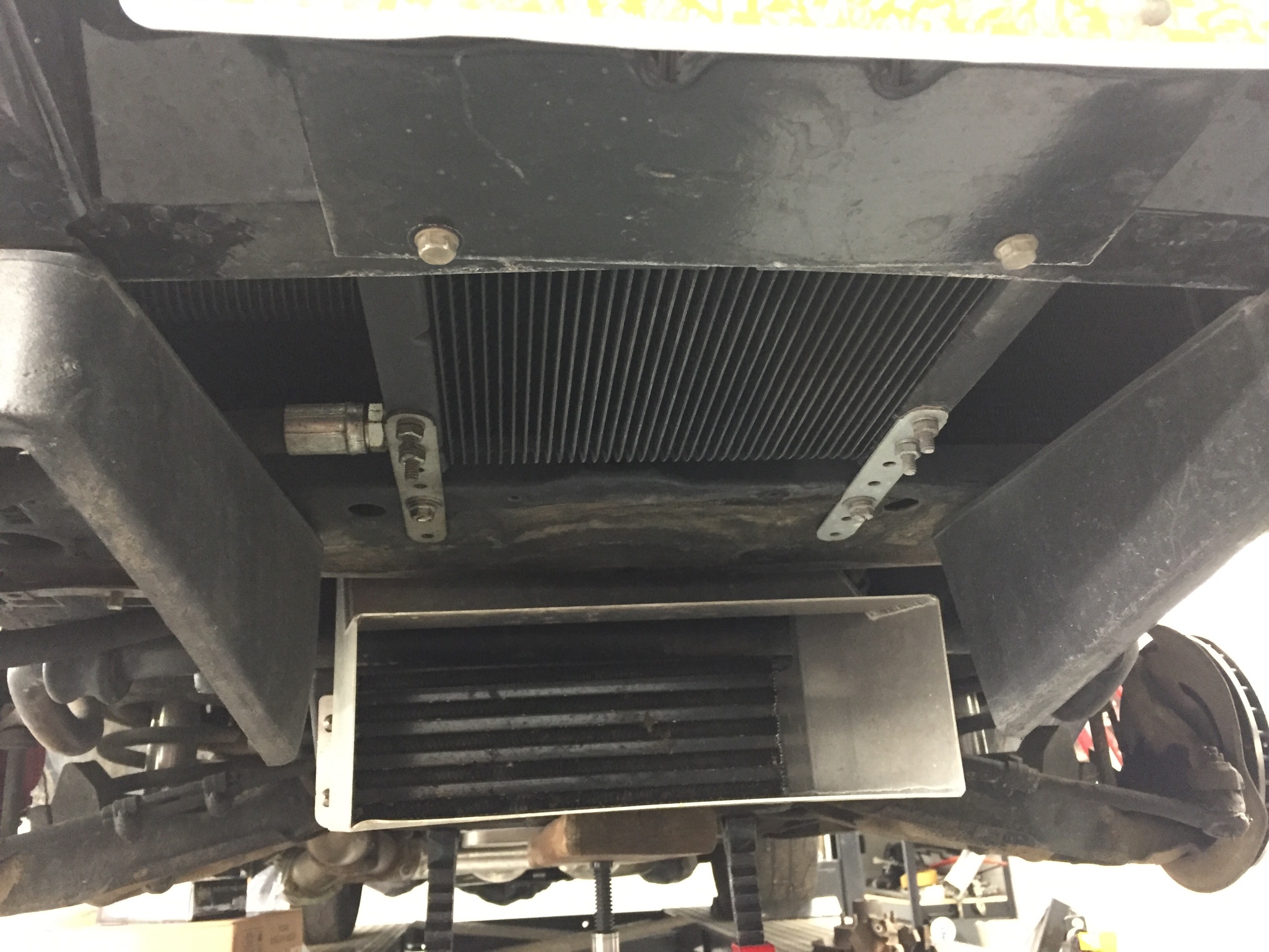

Decided to amp up my trans cooling. Bought the Derale 13900. Read a lot about mounting locations but really think I’ve only got 2. Don’t really want to mount in the rear or mid. That leaves front DS or PS as I’ve got a SLIC and an engine oil cooler in the middle. I’d like to put it on the PS, but it would be right under the alky pump. No issues on DS except I’d have to run the lines across. Thoughts?

Mount it passenger front. Best overall that way
Ok if under the alky pump isn’t an issue that’s where it will go. I’ll wire the fan as a puller and it should be good.
If the alky pump fails, it's going to leak all over the fan & cooler. Just something to think about.
