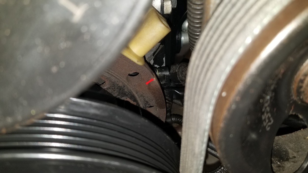

So when turning in the direction of the engine cranking (CW if looking at the front of the motor), the Caspers light comes on here

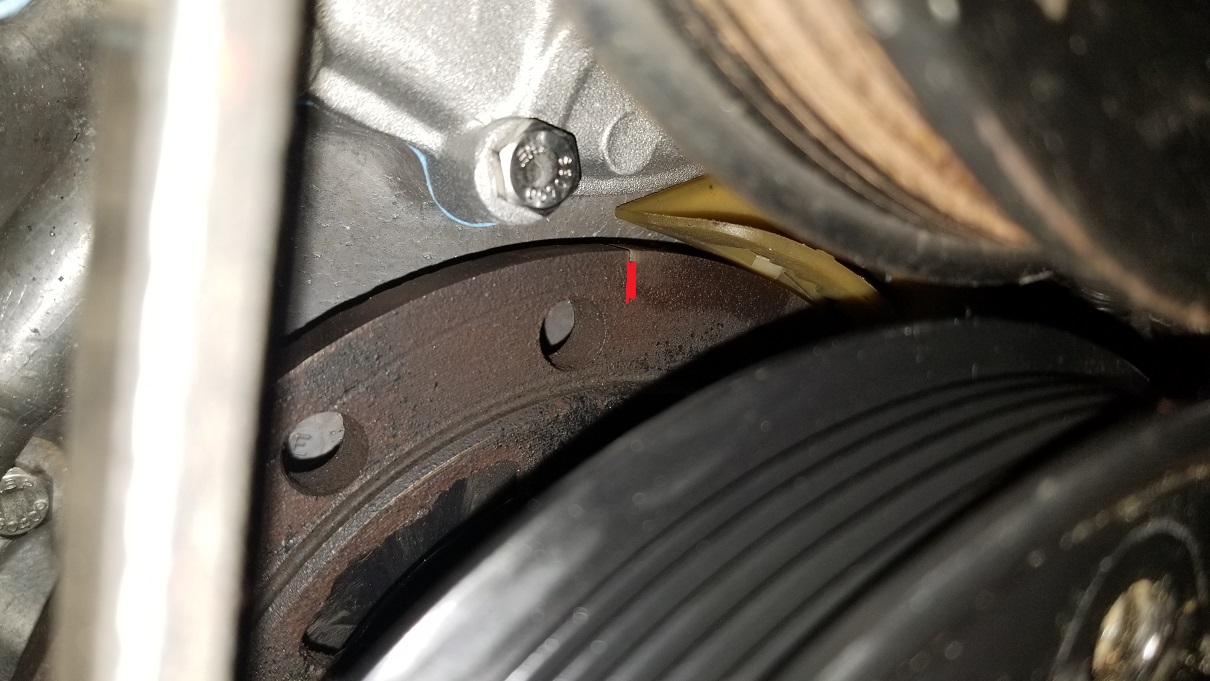

and off here (25ATDC)
