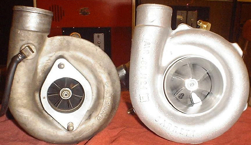

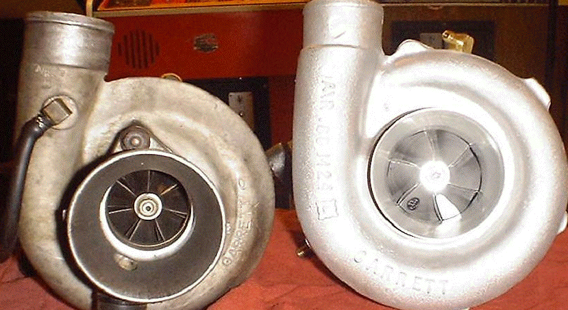

And here are a couple of pictures of a stock 86/87 TBO-348 turbo.
Stocker with stock inlet bell next to a TE-44.
Stocker w/o inlet bell next to a TE-44.
Hope some of this helps a little.
Patrick
