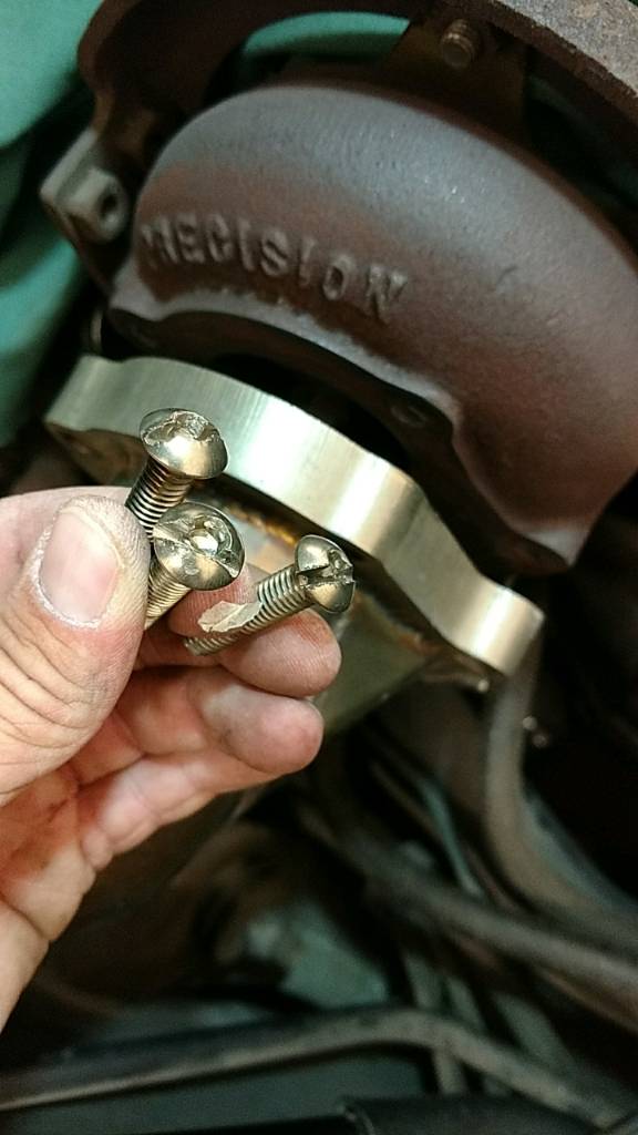

What style of bolts are you guys using. I tried stainless Allan head and had to cut them off.

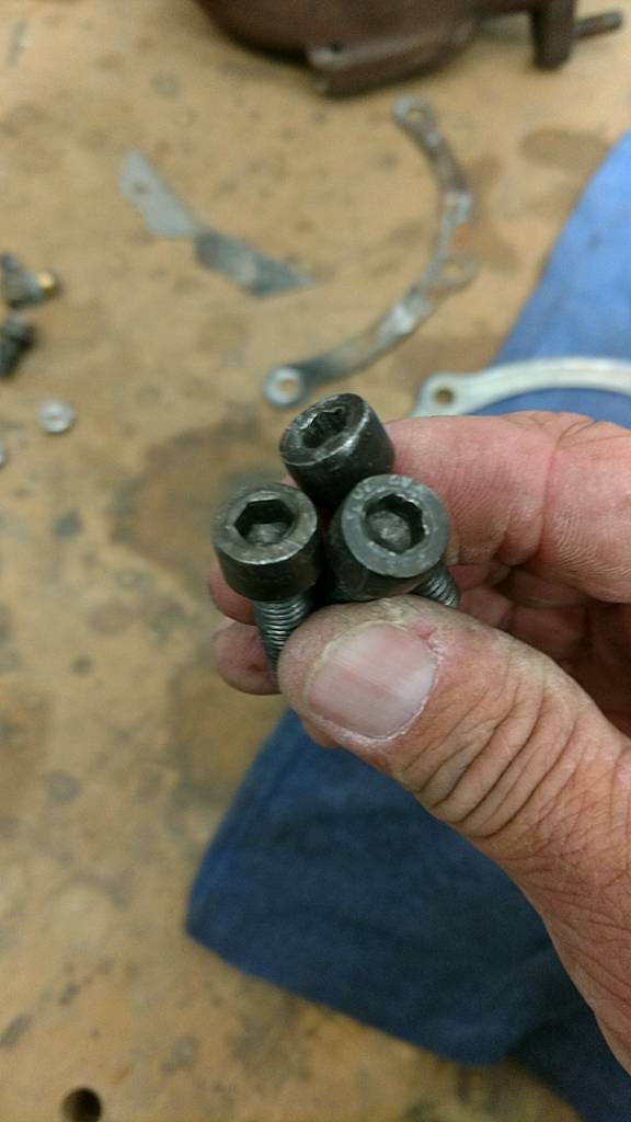

Here is the crappy ones I had to cut, the allan just turned on it. Soft

These are stock style ones, is that what you use, but stainless?
