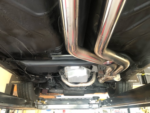

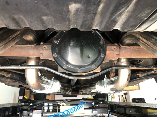

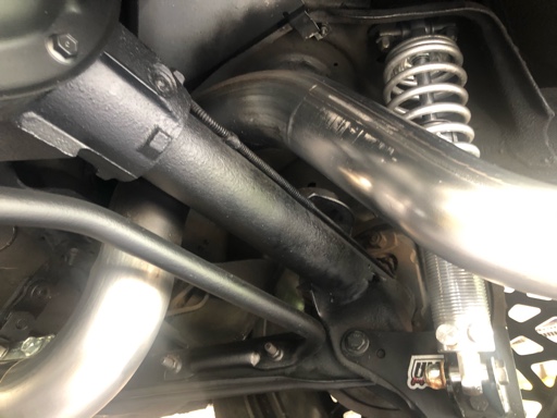

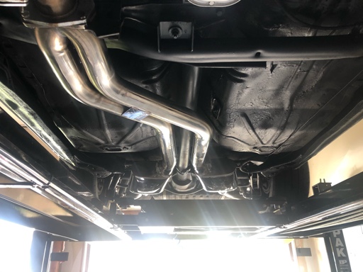

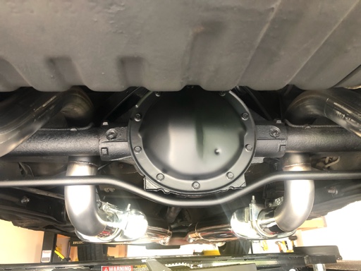

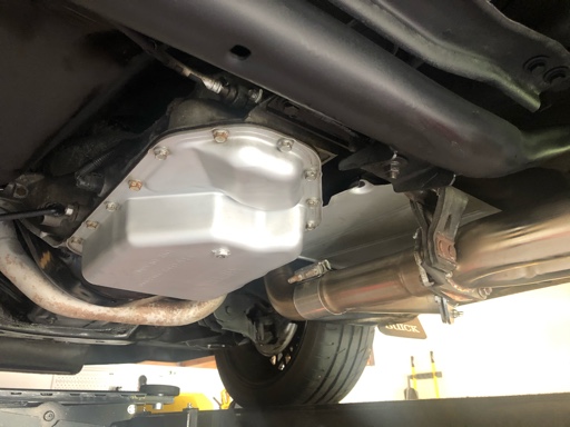

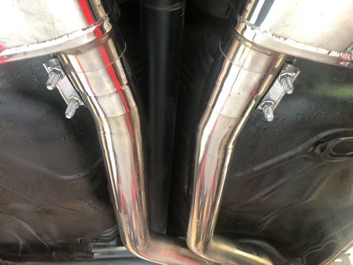

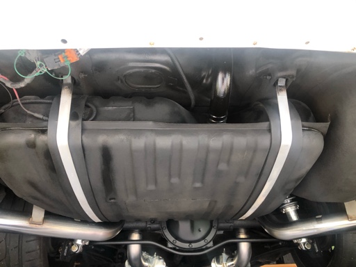

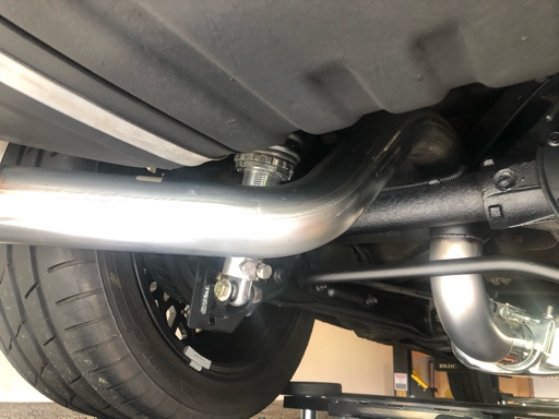

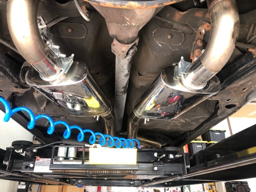

Was able to use a buddy’s lift for the day so spent a handful of hours under the car getting it cleaned up. The rust converter worked very well, especially being that it’s only $6 a can at Walmart. Just wire brushed all the loose stuff off and cleaned it with brake cleaner. Applied a few coats and it looks great. We’ll see how well it holds up. Also hand polished the Pypes exhaust as best I could. Lots of bend marks that would need to be sanded and machine buffed to look really good. Before and after shots.
Years ago when I used that product it lasted a good while but I never drove the car in the rain. It should be top coated if you want it to last in the elements. Either way, looks damn good!
I hit most areas with some undercoating after the rust treatment. Didn’t spray the diff cover wanted to keep that looking smooth.

Is that a real GN, I don't see any oil stains on the cross over pipe?
Real Turbo T lol. Give it time it will leak eventually. Even the speedo gear is dry!
