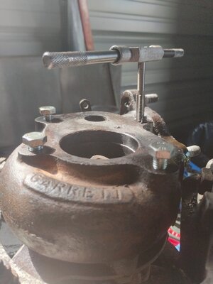

Dangit
I see more than a 12 dollar bastard file in your future. It can be fixed. Lots of different techniques to get those broken bolts out and you may need to try several before there out.
Gonna start with left handed bits and extractors and lots of patience..... Then comes the hot wrench, it can't stay in there if it's molten
That thing belongs in the nearest scrap pile ,,, i just sold a perfectly fine Ta-49 for $400..meaning there are super cheap deals out there to be had. The labor and unsure results will be big with that mess.
I can't ever seem to get so lucky, TA49 would be sweet, the turbo itself functions fine though, just had a minor leak, and then I created a probleme lol.
