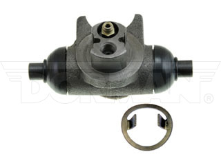

I'm going to start 1/8th mile bracket racing with my new car at the local track after a couple years off. I have a hydroboost system and I'll be launching off the foot brake. I remember there's a set up using larger brake cylinders and different shoes/pads that help at the launch. Does anyone know what these are?
Larger rear 7/8” bore brake cylinders off a manual S-10 (probably 98-05)
