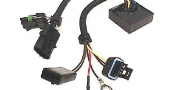

The consensus seems to be that my next steps should be an upgraded fuel pump and a hotwire kit.

It’s best to get a new fuel pump hanger with upgraded wiring, in this case just get a complete Racetronix setup (pump and hanger assy w/ hotwire) from Full throttle, Cruz Performance or whoever is closest to you (shipping).
The factory wiring bulkhead at the top of the hanger has been known to cause trouble with larger than stock pumps.

Links: hot wire kit
Volt booster

I believe a 255 lph pump with a hot wire kit and a volt booster is good for close to 500 hp on gasoline. Not as much on E85.
Just in case you’re not familiar.
Links: hot wire kit
Volt booster

1986 Buick said it best .First you need to upgrade the wiring to the pump.
