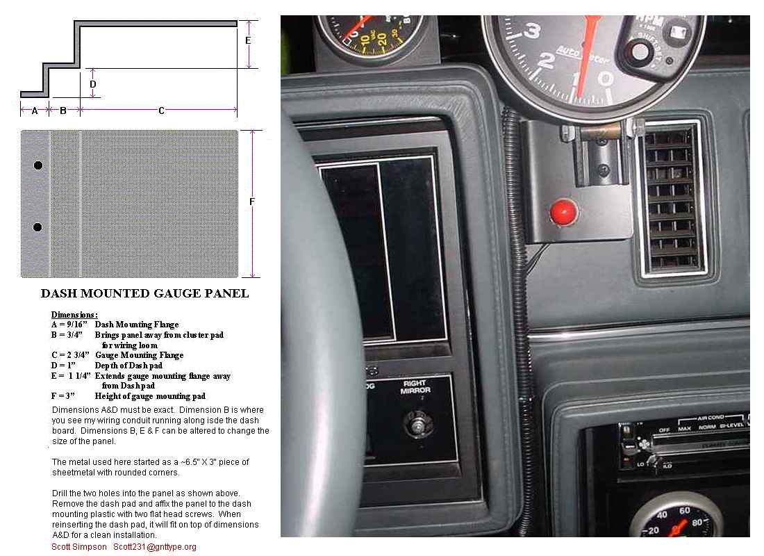

I did find this template for a tach mount on our sister site and thought it might be a good idea...
The wideband came with a little stand that bolts to a hard surface and can be bent to a 90 degree angle.
The result of mating a GNS tach bracket to the M-300's bracket. I even used it as a new home for the Scanmaster. :cool:
That turned out looking real nice! Neat to see other ideas used with the hidden bracket.
Scot W.
