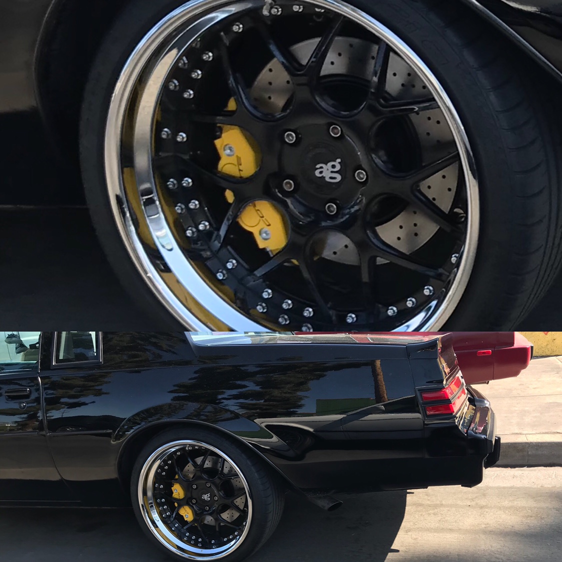

Can some one guide me to an older post or give me some info on putting z06 14” rotors and z06 front calipers on the rear? I know they make brackets. Does the bracket change the off set? I have seen videos of guys cutting the rear end ears off to put blazer and ls1 disk but will that work with the z06 set up also?

You want to put z06 Front calipers on the rear?
I have 6 piston front and 4 piston rear z06 calipers
And the offset slightly changed on both front and rear.
Yea I’m greedy want 6 pistons on the rear too

Were u able to keep e brake?

Is there a kit for that or a homemade recipe? That is a badass setup.
You can buy the kit from Kore 3 for like 2500 or you can piece it together for alot less. The bracket is and spindle are the main components needed.
