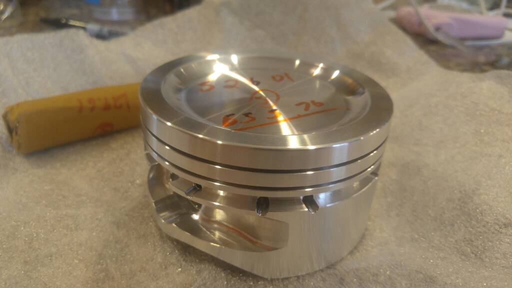

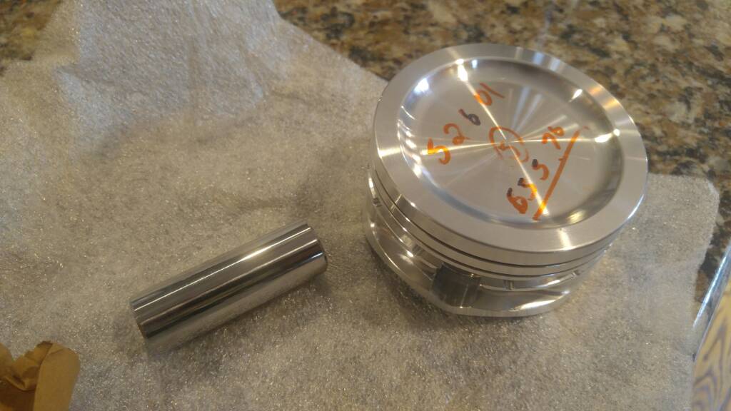

Well after returning home from the TB nats as a spectator I had a box waiting for me. These are custom built for this engine build and look great. With tool steel pins of course [emoji3]. Also waiting for me was my winter propane bill, and my wifes next college semester tuition bills.... So as always money will be my delay. I go on call this week so thats a help. Next step is probably going to be rods crank and rings from David Husek however I am still working with Bison for lifters, cam, rockers, and pushrods. One thing that I may start working on that hopefully wont break the bank is modifying a set of factory headers I have. I plan to have them welded to fix driver side leak, add a high pressure bellows in the crossover, and an external gate below the turbo flange then have the flanges decked flat.

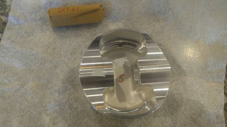

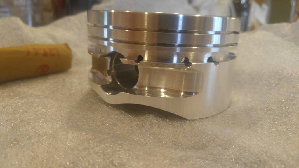

This is one of my Race Tech pistons. They look just like yours because your pistons are Race Tech pistons.

They're identical because they are the same Race Tech pistons. They probably have a different dish volume and pin location,but they are the same pistons. These are not pistons designed by Earl. They are pistons that Earl likes,that Race Tech makes. I like them as well,so I chose the dish volume,diameter,ring grooves,and pin location that I wanted to get to my desired compression ratio while using a .027" thick head gasket that allows the best port alignment to my TA SE head ports. I purchased these through Dave Husek who also likes them. These are very robust pistons.
Those are the older designed pistons. They're pretty much the top of 90's technology from when the lead engineer was Kenny Dutweilders piston guy. Those use a SBC pin but have Buicks in mind when designed. Very slight changes from then until now. Those aren't my design, that's how Dave was able to get them.
These are the ones that I designed and nobody but me can get. With these, they'll make a little less noise from a taller skirt and less thermal expansion, and can use either a Buick .940 pin or a .927 SBC pin. Both have the same default metric ring pack.
