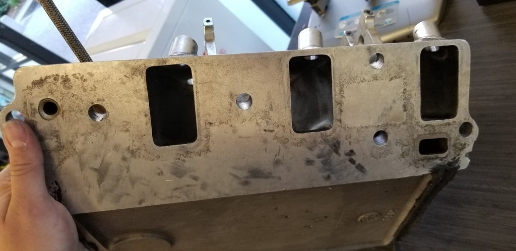

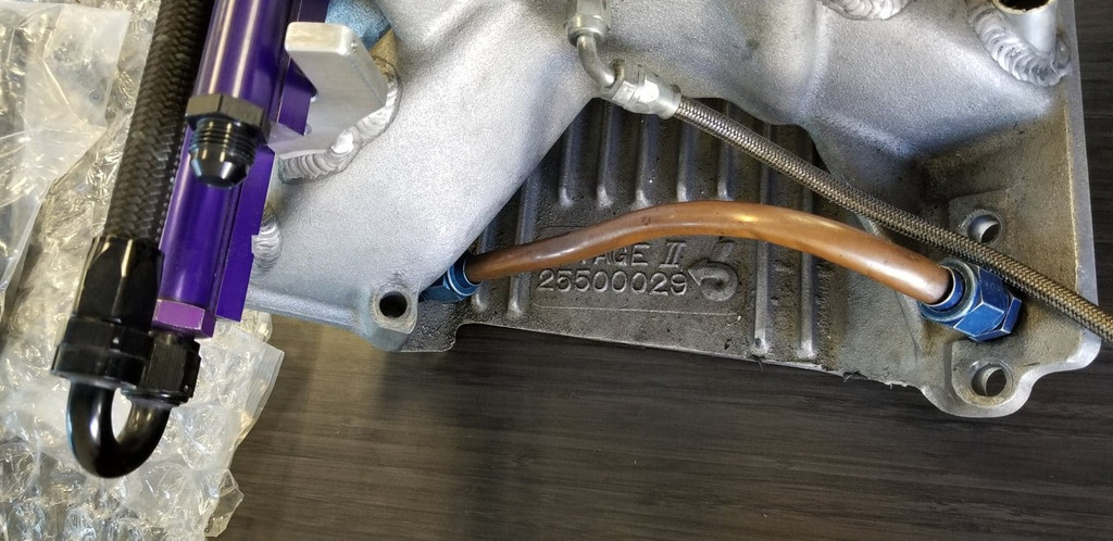

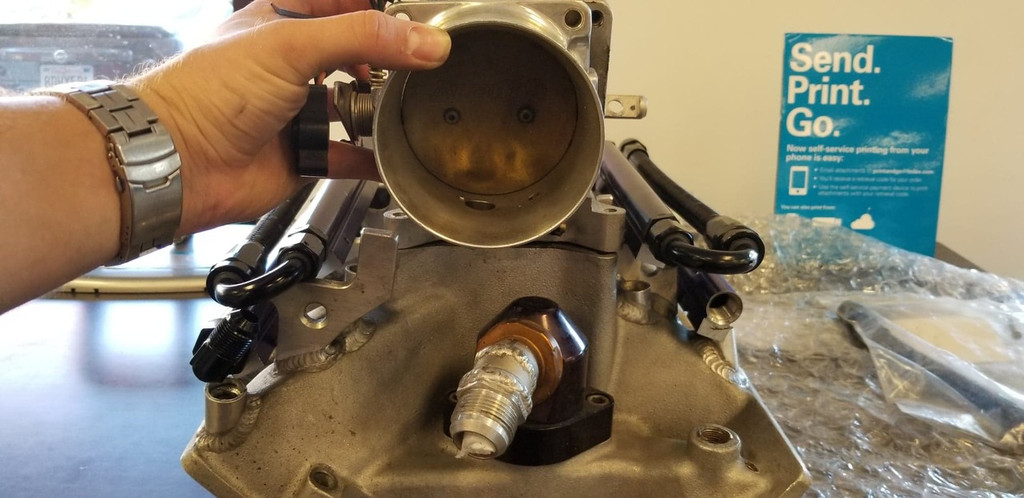

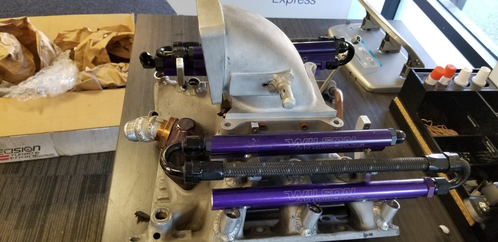

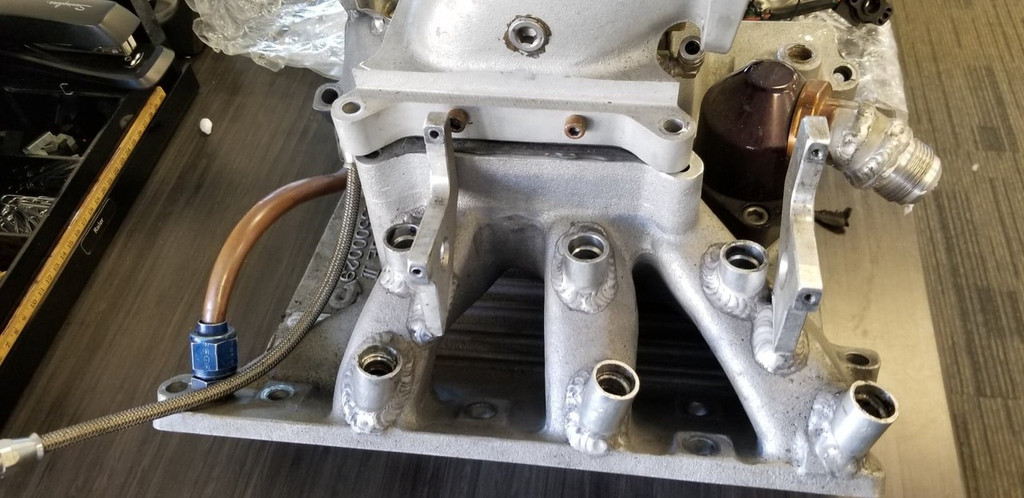

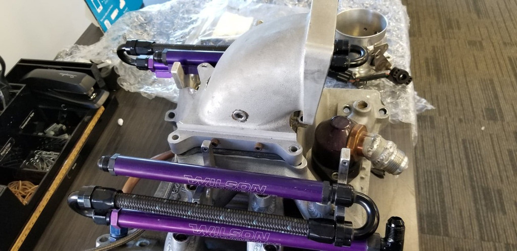

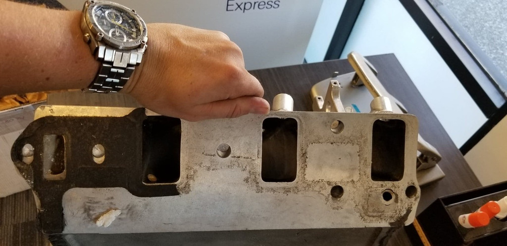

As promised, here are some pics of my Stage 2 intake I picked up today that Fat Nat sold me. This intake was fully ported by Wilson Manifolds and made 1572hp previously. I'll be shooting to top that number by 100hp on Kenny Duttweiler's dyno when he builds my engine.
Very nice! My buddy did some work for Keith. I've met him and his wife. At the time he had a wicked Stage II manifold he built for PTE. I think it was an $8k piece! He has some really good racing stories too.
