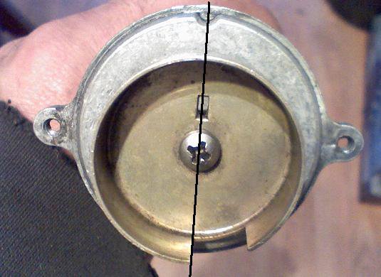

can't get cam sensor set right
Correct sorry. The dot should be lined up with the notch that is on the platform that the cam sensor cap sits on. Which is the back of the cap, not the pigtail harness.
Yes that's what I've been doing, well going to start looing at fuses, injector pulse, crank sensor, Thanks
This pic helped me do mine.
Okay so you are positive you are on the COMPRESSION stroke of the number 1 cylinder? Double check. So you are at Top Dead Center or #1 then you would go about 1.25” past TDC . Drop the cam sensor in with the window facing the drivers side while making sure you ingauge the oil pump .after that u put the cap on and rotate it clockwise till the light goes off then back till it just turns on and lock it down and it’s set . If you follow exactly what I have written your cam sensor will be set . The number one thing people get wrong is the COMPRESSION stroke of #1 cylinder
