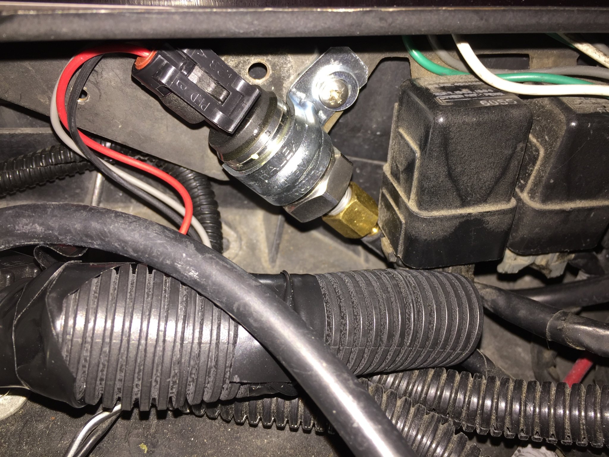

Got my 3.5 installed. Thanks Brian!!
Is that the vaccumn line plugged into the bottom, look pretty easy. I like easy. I seem to remember Bison testing like five stock sensors and all them failed in one way or another.
Yes. Very nice little barb on the end. I mounted the SSI in the same location the stock unit came out of just using a conduit clamp to mount it.
