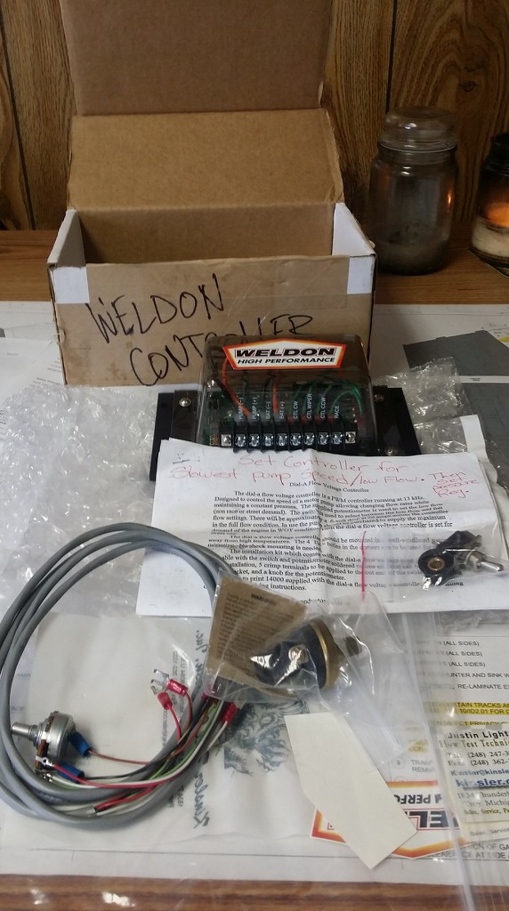

As for a pump selection, I prefer to go on the larger side just in case I ever want to switch to full methanol. I'll be running E85 to start with, and a fuel pump controller to help prevent heating the fuel.

Weldon 14000 Controller:
