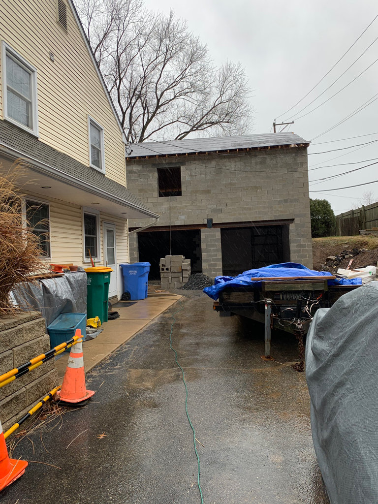

Well my update we had sub zero temps this weekend and some of the tar paper came off the roof. It was replaced yesterday. The old concrete pad was cut with a diamond blade for a straight cut. Expansion joint will be added. All the stone has been placed might be actually able to get some concrete down Monday/Tuesday with temps reaching 40’s and dry. My original garage was 20x 24 and now is 28’x 36’ with a second floor. Room upstairs will be 20x21 and will have another room over the lift area or just close it up for an attic. Not sure yet I just want it to get to the point so the township inspector can sign off on it. They are so strict with the sq footage and they don’t want the upstairs to be a living quarters. So every thing is being presented as unfinished to get past that. Lucky the next couple weeks my GN that is here will be sitting at the Philadelphia 2019 Auto Show downtown. My WE4 is squatting in Mark’s garage for the winter!
