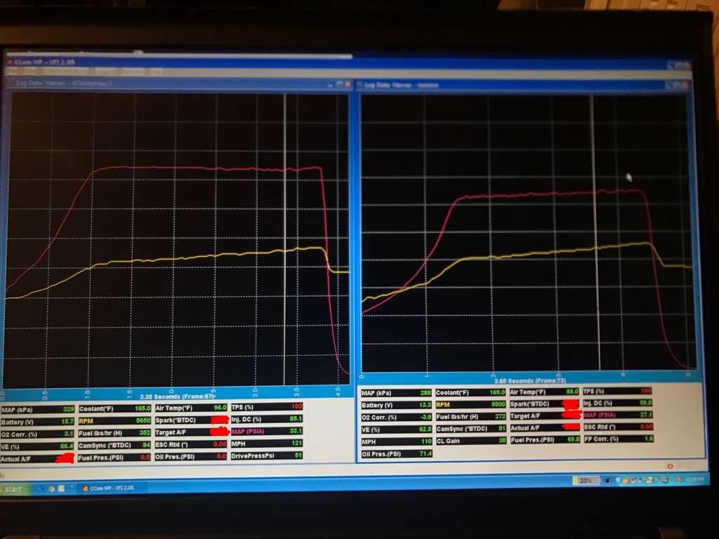

You shouldn't be using only manifold pressure as your reference point for how efficient an engine is. I will say that engines that make the power at lower manifold pressures with no other changes will typically go noticeably faster because the turbo has less work to do to move the air. You may go backward in power trying to make 35psi. Exhaust pressure in the 80's and cylinder fill in the crapper. When the exhaust pressure vs manifold pressure starts getting ugly the power (VE) falls off a cliff. So to get that engine more efficient only mechanical aspects of it can improve it. You're al out of manifold pressures positive effect to fill the cylinder. So raise the CR, reduce valve overlap, taller gearing, converter very specific, or leave everything the way it was and go with more turbo, specifically the hot side since it seems to be the biggest bottleneck on most engines. If I were to go all in on the turbo I have little doubt that on the 9.45:1 engine it would make much more than my 8.3:1 and it would run the turbo out at lower manifold pressures.
Here's a 9.45:1 Iron head engine. Looks like about 1 sec to 15psi. Half throttle foot brake MFS 6766 .85 a/r. His engine makes the same power as the 8.3:1 aluminum headed (higher flowing potential for sure) stock short block engine in the blue car at approximately about 7 psi less manifold pressure. Same turbo on both engines. Cam overlap within 2 degrees of each other at .050". It's not just a little gain in efficiency. It's huge in this example.
Here's a couple quick hits from above mentioned engines. Both of these hits are peak of approximately 640whp give or take a few and mine falls off at 5800. His was still cranking it out to 6000-6100 where I stopped the highest rpm hits. They are both same port injected 93/alky with SSI 3.5 bar MAP sensors, same turbo, his is iron heads, mine has ported aluminum similar converters (his 16 blade 9.5" and mine 17 blade 9.5"), very similar cams, etc. Notice his manifold pressure is 6+psi less than mine even though I have better heads, and honestly a lot more refinement in the tune on mine since I've had it for several years. His at the point of this log had only had about 25 seconds of WOT time on it at the end of this hit and I was adding manifold pressure every hit. As you can see the VE % is a little higher on mine but I was also targeting a richer a/f's and they play into the displayed VE a little and 6-7psi higher manifold pressure because of the alky injection. His engine is also much better with bsfc. Meaning it takes less fuel to make the same hp. The turbo wasn't close to all in on either. Imagine both tuned on good fuel and his engine at 33+psi manifold pressure? It would be 720+whp still on conservative timing and a/f numbers. I was a lot closer to all in than he was and he still has the same power as I do. The effects of raising the CR are drastic in this example. Of course the tuning window is more narrow but 9:1 isn't outrageous at all even with 93/alky. Dont fear the boost, don't fear the CR, watch out for the timing!
