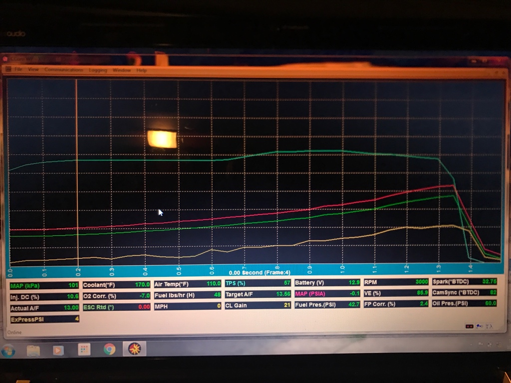

Excellent point. Hp should be thrown out the window and replaced with "mass flow" for more accurate comparisons of airflow through engines. About 75lbs/min is what you are seeing here on both logs.

Here's a 9.45:1 Iron head engine. Looks like about 1 sec to 15psi. Half throttle foot brake MFS 6766 .85 a/r. His engine makes the same power as the 8.3:1 aluminum headed (higher flowing potential for sure) stock short block engine in the blue car at approximately about 7 psi less manifold pressure. Same turbo on both engines. Cam overlap within 2 degrees of each other at .050". It's not just a little gain in efficiency. It's huge in this example.

He wouldn't put me on the trailer because I never trailered that car anywhere for one. Second I've got several hundred Dyno hits thousands of quick street hits, hundreds of hours of drive time in the street and way more suspension upgrades like better shocks, better rims and tires, car is about 300lbs less race weight, etc. I've already proven what the car can run with way less cool guy stuff and less power. He'd be making a lot more power but be noticeably slower. If we were to do nothing but take his engine and put it in my black car and let it eat it would be very bottom 9's.
