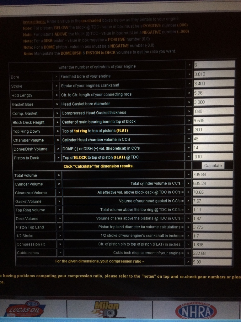

Was playing around on one last night. Not as elaborate...Didn't account for top ring location.

At that level of squeeze everything gets very critical......wouldn't reducing the dish another 5cc take it over 11.5:1?
I didn't calculate that out. Going on stock block and won't be able to pull enough timing without hurting power and throwing a lot of heat in the ex valve with 11.5. I think it's 10.38:1 with a .027" gasket if I feel the need
Did the math on the .027s too . Looks like your block has been decked and for the pistons to still be .010 in the hole you must have change the CH as well?
