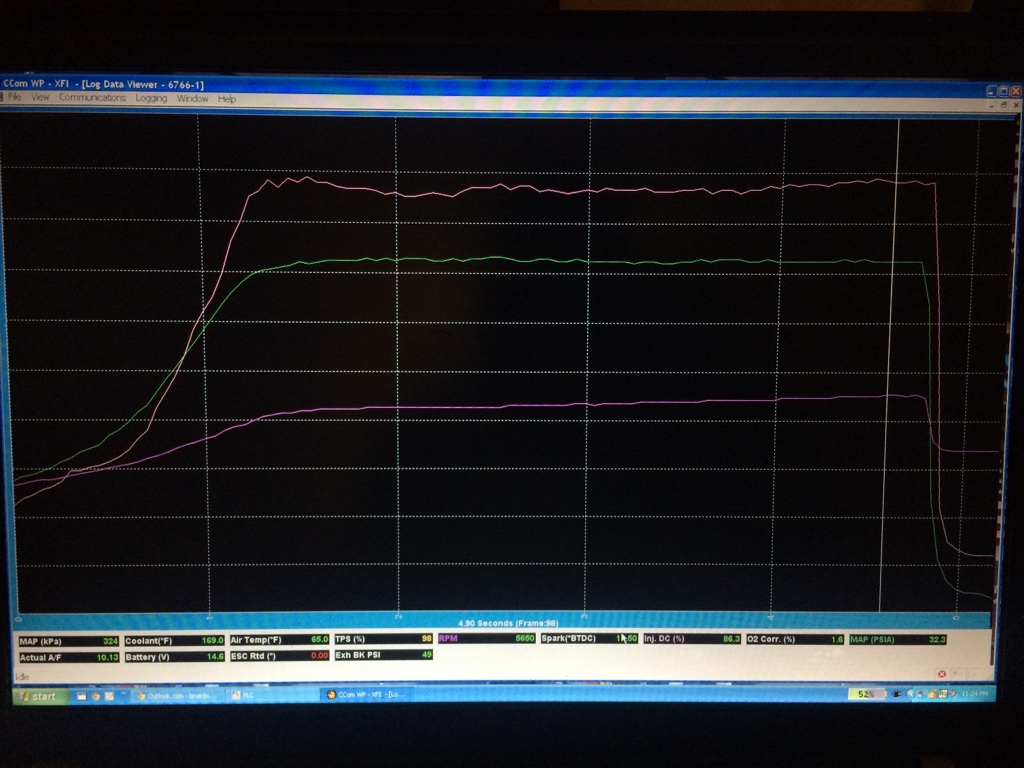

Back pressure data I aquired today. Air was about as shitty today as it was the day I dynoed. I noticed my GM style 3 bar MAP was reading 105kpa with key on engine off. Probably should be 98kpa with the crap air we had today. Anyway 28-29psi manifold pressure and approximately 40psi drive pressure. 1.37:1. This is using traditional wastegateing with an internal gate. This turbo is a lot better than I thought:
BPE2013@hotmail.com
Is the 1.37:1 your PR? If so, the the method I seen to calculate it had to be wrong. PR = (boost + 14.7)/14.7.
Backpressure÷Boost=PR. I think...
40÷29=1.37
That's for comparing exhaust to intake pressure. Not to be confused with the compressor pressure ratio. The correct way is using hot boost though. Which would improve the ratio. I don't have a hot boost calibrated MAP sensor so I used cold boost at the intake manifold after its seen pressure drop from the compressor outlet.

Just an update on the stock shortblock used here. It's still together and swallowing 32-33psi boost via a MFS 6766 on 93/alky. It's up approximately 50whp peak and over 70whp at 5600rpm over the MFS 6265. Haven't and don't plan on running this car again but it's a lot of fun on the street
That's a solid gain!
