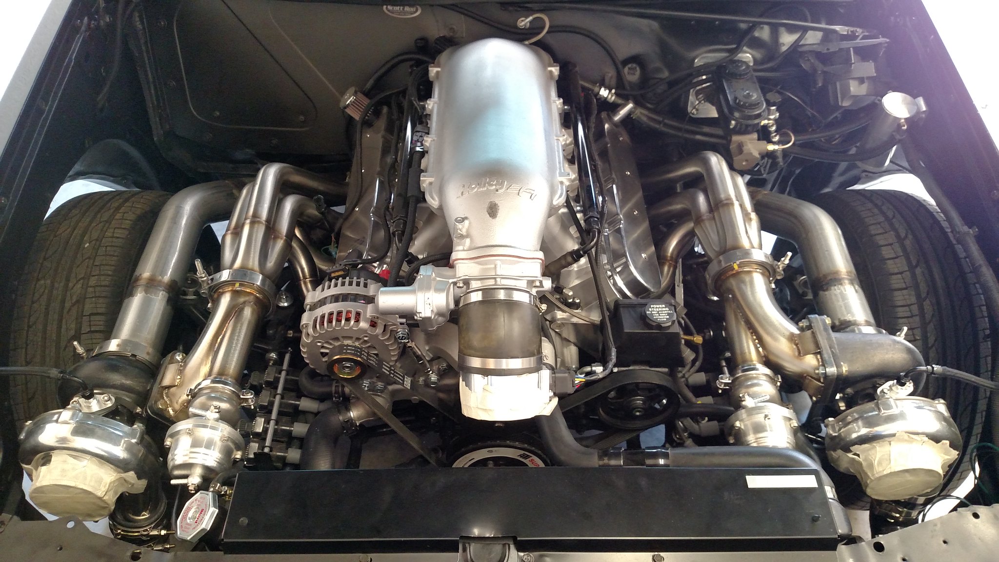

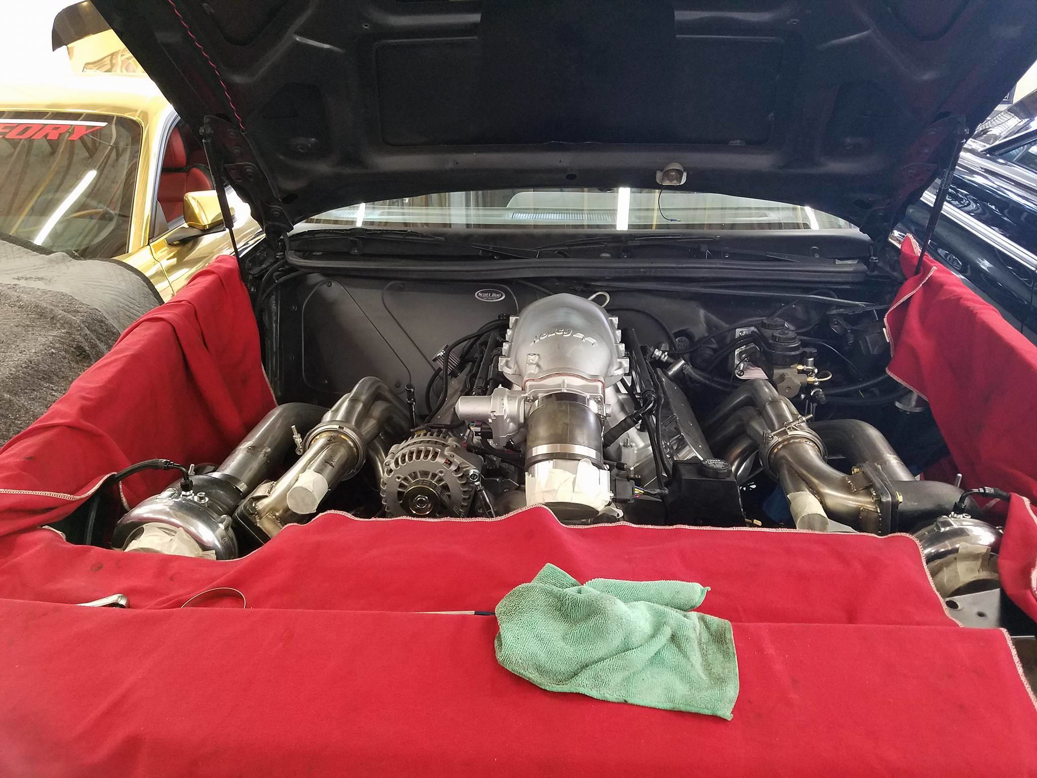

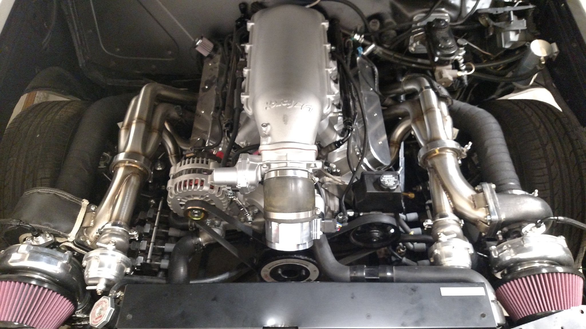

My LS Swap 6.0/4l80e Twin turbo
what made you decide to switch from the jardine headers to the cxracing? how are they?
Actually I am back to Jardine Headers. The CXracing headers were hitting my coil packs that are mounted on the frame. Didn't wanna change all that up, AGAIN!
With that being said, if I ever do another build, I will use the CX racing. With the Jardine headers, I had to dent a primary, change to manual brakes and a couple of others things that were a pain in the ass!
Trimmed about 1/4 off the throttle bracket hold down so that part is not touching. Will need to have the buldge extend a bit.
