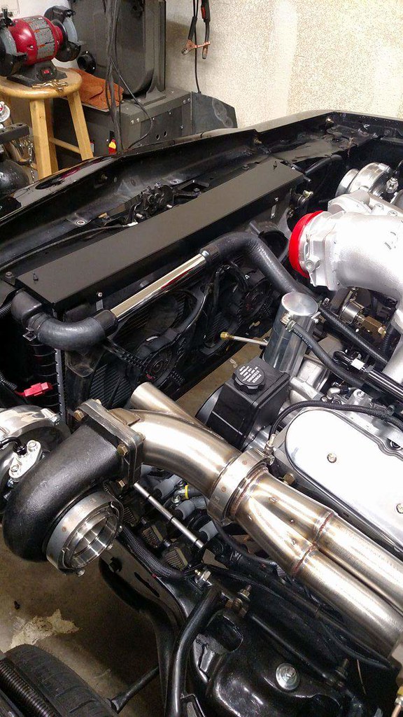

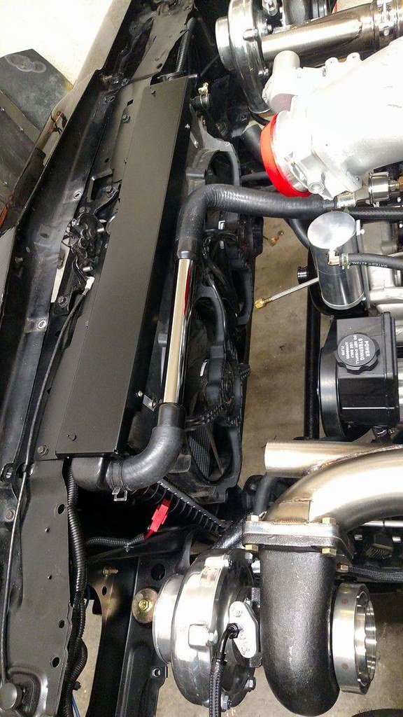

Robt, what radiator is that? I'm about to add 1 w/ the stock core support. I've been looking at the Holley rads, but they are rt side upper and lower hoses. My turbo is there.
