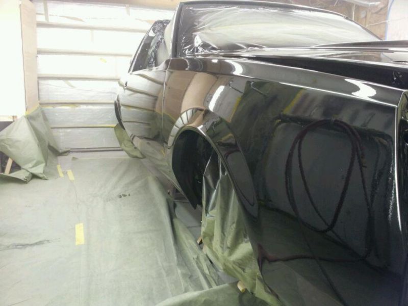

Body came out very straight. Will post up again when she goes back together.

currently in the sanding and buffing stages...
The body should be complete this weekend..

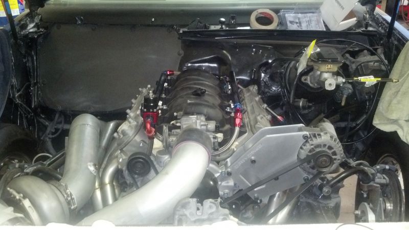

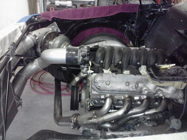

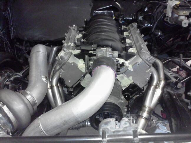

Updates coming soon. Engine and trans is back in, correct wheels are on it, it's going together.

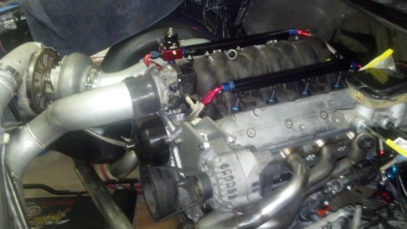

Just a couple quick phone pics, it's on its way back together.
Regarding the brakes, they are the "Pro Street" version of Wilwood brakes on the front. They are heavier than the race version but still lighter than stock and you can put street miles on them. You can see we converted to vacuum brakes.
The car is being assembled and plumbed now, but we had a couple issues with the rear end and the converter and stuff, so there have been delays. After it goes back together it has to go back to the fab shop for the wastegates, blow-off valves, and radiator tabs. After that it gets wired.
