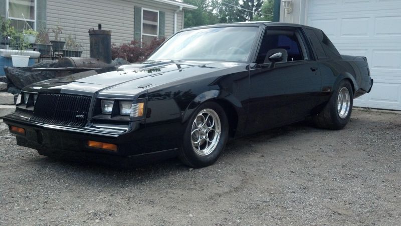

SignUp Now!How did you get the front to sit like that I have 325-50-15 out back and want my front to sit just like that too sweet

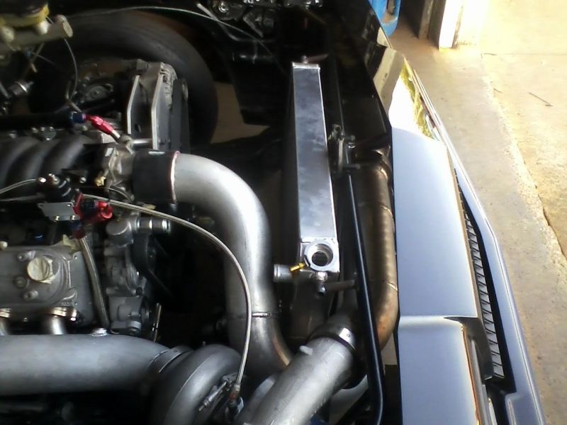

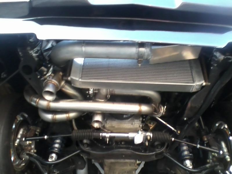

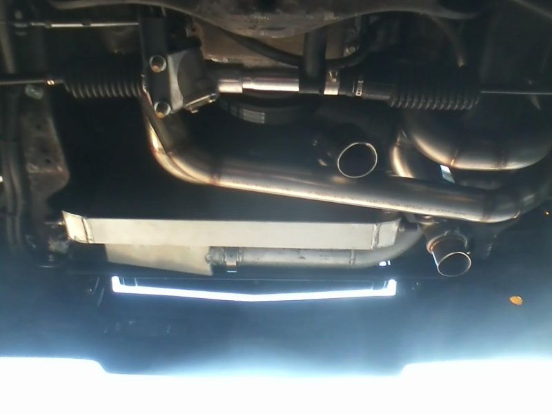

I'm told it was originally from a 12 liter bus engine, it's a Garrett turbo, and I think it's 80mm.

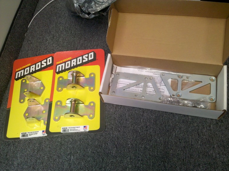

The engine mounts showed up, so I hope to have shots of it sitting in the car soon. These mounts and adapters are said to set the engine low and back compared to other swap mounts, which is always good in a drag car. I was told these would place the ls engine in such a way that it could bolt to the stock GN trans. This car has already previously had a TH400 in it behind a v6 in the stock location, and we're using a TH400 as well. The TH400 cross-member is still in the car. So theoretically, this should be a bolt in. We'll see.
Part numbers are:
Moroso 62530
Moroso 62630
Edelbrock 6706

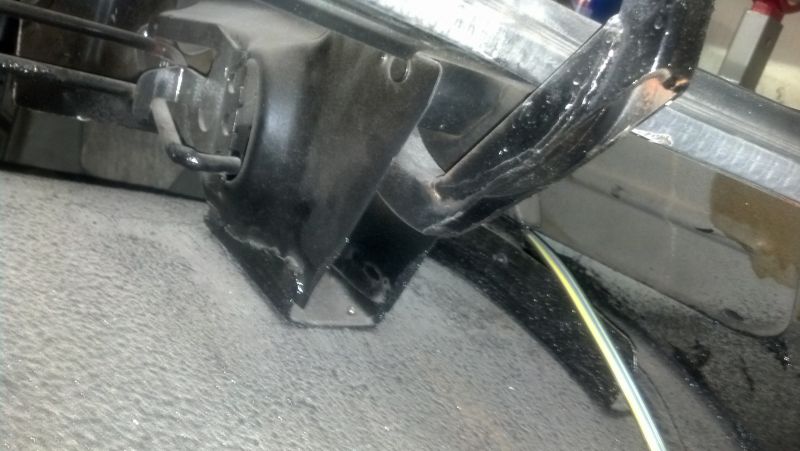

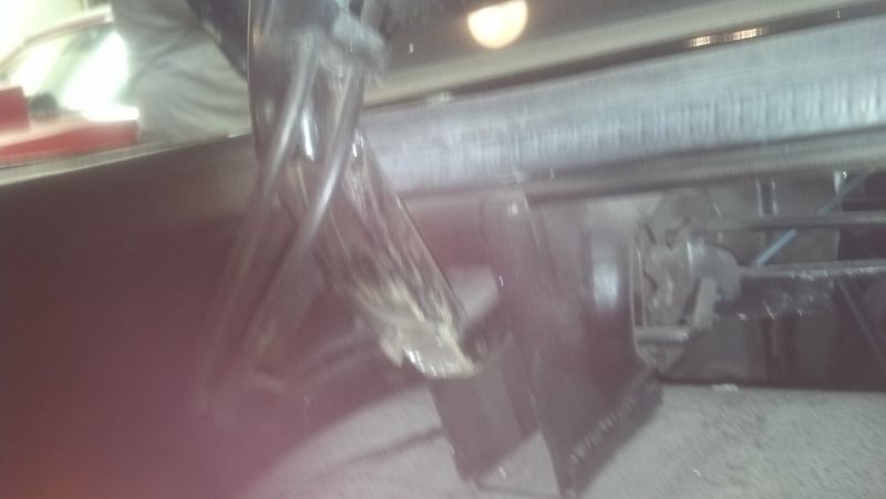

The hinges appear to be modified by cutting off the bottom round part of the hinge, and welding it back on the top side. This was done before I got the car. Here are some pics:
I tried to order these part numbers but the Edelbrock number is not available from vendor...any suggestions????
That prevents the bottom of the hinges from hitting the tubs....
My post was in response to the guy who asked how the hinges were modified to clear the tubs![]()
