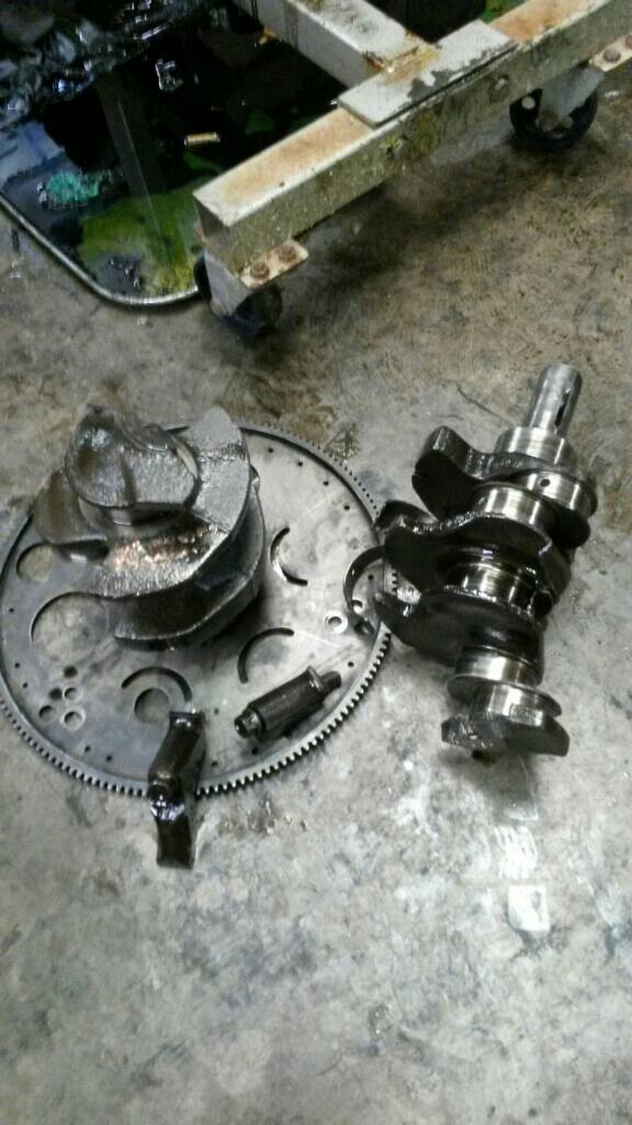

I just sheared my stock crank in half.....the front main bearings seized up because of a faulty oil pump....this caused the excessive torsion in the crankshaft, which caused it to shear in half.

I did break a stock crank on a completely stock long block a long time ago. All the motors I build now have a RJC girdles on them. Never broke a crank with a girdle on the motor.
Thank you, I will definitely buy a RJC girdle for my rebuild (currently in progress).
