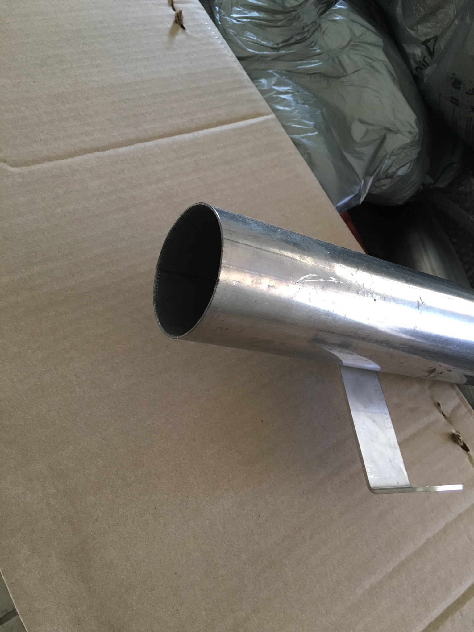

Does anyone have a picture of the four bolt flange and it's opening? On the 2.5 inch version, exhaust flow is bottle-necked at this flange. Hopefully, on this new setup they enlarged the opening for us guys with 3.5 inch and larger downpipes.
