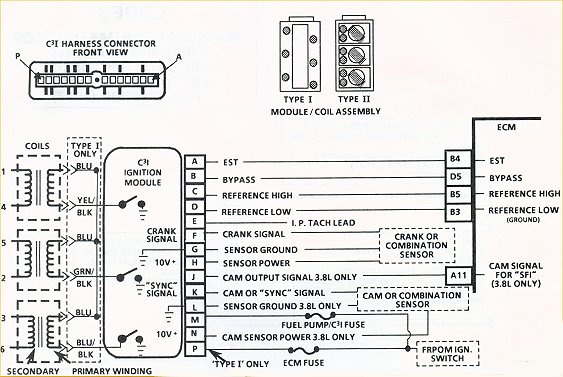

Hello guys, I have a customers car at the shop and cannot get any spark from it. I need some advaice on what other parts could cause a no spark situation other than what I have replaced.
I have tried 5 different modules on the car, two of which have been GM AC Delco units. It has a new coil pack, crank sensor, cam sensor, and both of them are set up correctly. I have checked fuses and all of them are good. I just dont know where to go at this point. It has a new injector harness and alot of other new parts that someone else replaced.
I have voltage at the pink/blk wires at the module. I also have 11v at the a&C connections on the cam a crank sensor. If I check those to ground then I have 11 on a but only 7.5 on C.
If anyone can help me it would be greatly appreciated, my customer would really like to have his car back and I would really love to get it going for him. Thanks a bunch in advance!!!!

There are two pink and blacks on the module that should have power. Pin p and pin m.
Yes the light is on when the key is on, it does not have any codes. I forgot to mention earlier that the car is an 84 but it has an adapter that's plugs in and accepts the 86/87 module and coil. I have the voltages on the important things posted in the original post. Thanks again
What is the difference in the type 1 and type 2 coil assemblys? Mine looks like the type 1 from the picture above.
Nick, Parton me for asking a dumb question but when we spoke earlier, you said to check continuity on the signal wire. My question is where do I check the continuity to? From signal to a or signal to c, may e even something else. I will check it all out in themorning..... Thanks again for the help

at the crank and cam sensors you should have approx 10 volts on pin A
you should have 0 volts (ground) on pin C
Pin B is the signal pin and should be close to 10 or close to 0 depending on where the engine stopped.
(you should not have volts on pin C)
All 3 wires from crank and cam sensors go to the coil module.

My bet is on the adapter harness. It's either configured wrong or has a flaky connection.
