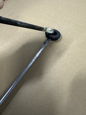

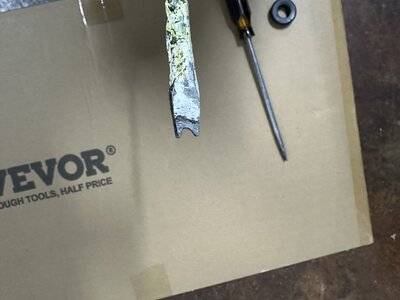

I made a special tool out of any old screwdriver by grinding a notch in the end of the blade. That is used to hold the grommet in place as you side the rear lip into the hole . Then use another large screwdriver to press the front lip back and down into the hole. First I put the grommet in some very hot water for about 5 minutes to soften it up and make it more flexible.

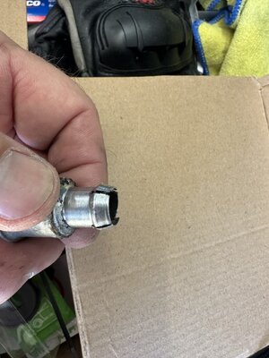

I did some experimenting with an old pcv valve and a new Dorman grommet # 42056. I cut the flare off the end of the old valve and pressed the throat of the valve into the center hole of this grommet. It was too tight. The throat measured 0.49" and the hole only 0.42" The flare was 0.57" which is very difficult to press in without pushing the grommet into the intake.
So I took a dremel tool with a long grinder bit and removed some of the ID of the grommet. got it to approx. 0.45" That was a good snug fit without excessive force to press it in. And for the flare, I used a cut-off wheel on the dremel to cut 4 vertical notches down the length and just past the flare. That allowed the flare to contract as it's being pushed into the grommet then expand back out once it passes completely through. I worked great.
