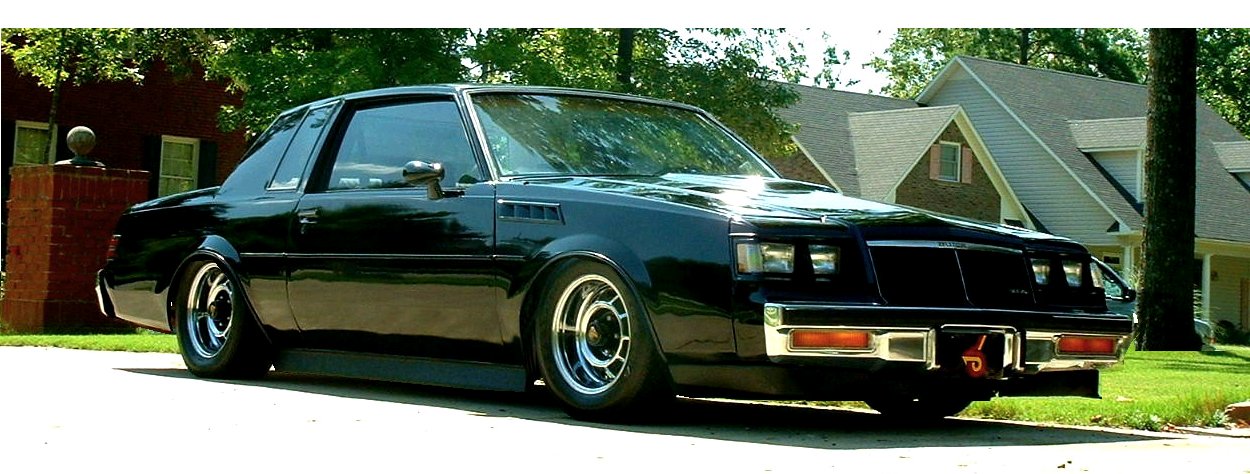

hey guys.. i wanna lower my 84 t a little bit.. ;)
id LOVE it to look like this:
http://home.attbi.com/~nbx23/dropped.jpg
is that possible with just springs? or would i need spindles and other things to fix camber and what not?
oh and just incase shocks matter, i have bilsteins all around..
Whos car is that? Looks very similar to mine. I would like to lower my car as well to achieve a stance like that. Maybe just a little lower.
My guess would be that that car has drop spindles. :confused:
How much lower than stock.
That look can be accomplished with either springs or spindles. Depends on the ride quality that you want. Springs will give you a stiffer ride whereas spindles will keep stock ride quality. Problem with spindles is that since the car is now lower, and the springs are still assuming normal height, you will have more bottoming out.
BTW, how much lower than stock is that. That looks amazing.

a question for the spindle people.. i suppose drop spindles would prevent me from ever using the 12" brake and spindle upgrade? any way to make them both work?

not exactly sure, id love for the tires to just completely fill the fenderwells, as in maybe you could slide a thin ruler between the fender lip (i have no wheel well trim) and the top of the tire, but nothing more than that

i went outside and measured 26 3/8th and 27 3/4 front/rear

I'm at 23 3/4, and 26.
12 front discs. Using the 700lb/in front springs and trimmed Fbody rears, with bilsteins.
Stock front sway bar and ATR rear.
Yes, it does handle...........
We tried the dropped spindles, on my neighbors car and they weren't low enough, so wound up trimming the springs but with big tires was a PITA not to have tires rubbing, the oem chamber curve sucks, so your better off using shorter springs, IMO..

go there, thats how i want my car to sit, maybe a tad higher in the back, like half an inch, and half an inch lower in the front. but i like that level, Bruce, do you have any pictures of your car you could send me? i wanna see how 23 inches or so looks up front, i think i want 25 inches in the back.
Bruce is correct, when using stock spindles, the OEM camber curve makes the tire lean out at the top when tire is in bump (outside tire in turn). This causes tire to rub. When lowering front you have two options:
(1) Use B-spindle setup (like Bruce) which changes camber curve so tire leans in in bump creating more tire clearance. This setup has two downsides, (a) you have to make changes in tie rod connections to get bump steer corrected, (b) B-spindle pushes wheel hub out by about 1/2-inch so you need to change backspacing to have improve outside tire clearance and to minimize the scrub radius.
(2) Modify stock metric spindles with longer B-body ball joints. This lowers the car an extra 1/2-inch and also results in a chamberr curve almost like the B-spindles. You still have to work on tie rod ends to correct bump steer with this setup, but the wheel hub is in stock location. This setup does have a down side in that the stock top A-arm has some clearance problems now with the down pipe. With the same springs, this setup will result in a 1/2-inch lower front than the B-spindles unless you use dropped B-spindles.
Regarding the rear, lower springs are your only option. One caution regarding lowering the rear, do not lower the rear so much that the front mount for the rear arms is lower than the rear mount. This will not help the already pronounced problem of rear squat under load. If you do have to lower the car so that the rear trailing arm mount is higher than the front, I would modify the rear mount so the connection is the same height as the front. This in conjunction with the increased angle of the upper mount will reduce rear end squat. You need to check your rear instant center to confirm this.
I have modified my rear instant center to add anti-squat and my 60-ft time have been reduced and my control using power has also improved (I do not use air bags). I have less power overstear coming out of a corner.
Just my experience to date. Lots more to learn about setting these cars up.

so... with b spindles, GTA rears will fit on the front without spacers?
They look like they will. I have to get some tires mounted on mine, but the rears seem to fit pretty good with the 12" conversion.
Use springs to lower the car. With drop spindles, you will need springs anyway to keep the tires off the inner fenders, so why not just use springs.
