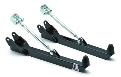

Is this design any better as a lift bar?

"jdpolzin", by looking at the picture that Scott ("Turbo6Chicago") posted, they appear square tube to me. I agree with you about mounting a flat bar to a round arm...is not the ideal way...
Hotchkiss, Metco, H&R and Spohn seem among the best to get...UMI also has some square one too...part# 3021 for Buick GN's
