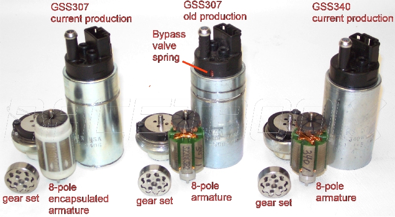

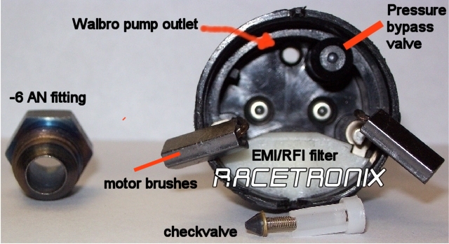

He does not install anything. You simply press the small retainer further into its channel which puts more pressure on the spring. We adjust these on all GSS294M pumps so that they do not open below 100PSI.
Many Walbro pumps exceed their 255LPH spec. We have some pumps which flow 270LPH+ out of the box. The 255LPH rating is nominal. If the pressure bypass valve is adjusted then a standard GSS340 / GSS294 will flow much better upwards of 80PSI.
Up until around year 2K the Walbro GSS307 and GSS340 shared all the same parts. The only difference was that the GSS340 had a heavier spring in its pressure relief valve. This allowed the GSS340 to operate at higher pressures before the valve would open to dump fuel back in the tank. People soon realized that by shimming / modifying the spring on the GSS307 the same performance could be had at a lesser price. The pressure relief valve is an important safety feature which prevents dangerous pressures being built up in the fuel system should the pump's outlet become restricted. Many vendors and customers started modifying the valve which must have been one of the contributing factors to Walbro's design changes to these pumps. Racetronix has seen performance tests conducted on GSS307 pumps many years ago where a shimmed GSS307 would outperform a GSS340. This data would be accurate in its day when both pumps shared the same armature but this no longer holds true. The sad part is that certain vendors use this dated information to sell customers on modified GSS307s just for the sake of putting a few extra dollars in their pockets. Current production GSS307 and GSS340 pumps no longer have an opening in the cap allowing access to the valve's spring. The current GSS307 has an armature design which is different from all of the GSS34x pumps in Walbro's lineup. This encapsulated armature is better suited to the lower pressure applications (under 60PSI) for which the GSS307 was originally intended. When compared to a GSS340 the GSS307 will draw more current to produce the same pressure. Many would ask why offer the GSS307 if the GSS340 can provide better performance all around? Perhaps the original idea was the price point? At one time normal retail on a Walbro GSS307 pump was around $200US. Today it is not uncommon to see the same product being sold for around $100.00. The cost difference between the two pumps is only a few dollars. Racetronix has therefore decided to discontinue offering the GSS307. Where applicable current product will be bundled with GSS340 pumps only. We believe this is in the best interest of our customers.

Pump output volume will increase at higher pressure if the bypass valve is adjusted b/c it will not be bleeding off in the tank.
Red (and Racetronix) never sold the F20000169, so the old problem with them was never part of this equation. All sold were based on 22mm inlet pumps such as the GSS340 and GSS294M.
If the bypass valve is adjusted for higher opening pressure then it is far less likely that debris would hang it up which helps eliminate a common type of failure.
If the pumps are pre-tested on a flow bench marginal pumps could be weeded out. Charging a premium would allow someone to absorb this loss and still maintain a profit. We do this as well without the premium.
