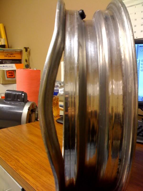

Think twice about going for the skinny look with Billet Specialties
Yikes! That doesn't give me a warm and fuzzy feeling. I like those to. I can see it possibly happening to one but both...:eek: So much fot streetable rims. Maybe you got a bad batch the first time around?
Dang Taylor, that's pretty bad! Other than that how's the car coming?
Wow :eek: i've never seen anything like that in all my years of racing , if you could watch that happen I wonder is it like an explosion or what . I'm curious to hear what the manufacturer said about this , and like what was said above God forbid this happens 100 plus mph going down the track :eek:

I am almost ready to buy them for my Mazda.. I am goin with 15X7s an 15X 10s .. that really doesn't give me a warm fuzzy feeling either.. The one thing about the net is word gets around quick!!! I had Weld pro stars break on me.. 15X5s from what I remember .. Weld didn't do a damm thing :mad: .. keep us informed what happeneds and what they say :frown:
They would be off of my car and fast.....:mad:
Even if they make it all good I would need some assurance and explanation.
15 by 3.5 if i remember right. Yeah in a perfect day theyd replace both fronts with 15 by 5. That would make me happy. Im just disappointed this time. The car hasnt been running right was looking forward to make a pass and then I look down and see that. Tack on another week+ of downtime. Ill keep this one going once I get off the phone with both Billet and Jegs. Its bull****:mad:

The first time it happened I wasnt out there and it was flat.
Today I backed the car out to be washed and I noticed it. It was still holding air. Lip of the tire was sticking through the crack. My guess is its a slow leak once the rim cracks. I bet going down the track its an explosion if you could hear it through slamming the wall.

This scared me ...So I emailed Billet Specialties-see respone
Here is there respone when I sent them this web loink and picture of the rim
Hello,
Thank you for your interest in Billet Specialties and our products.
I can assure you there is no problem/issue with our Street Lite line wheels, nor does any other wheel that we manf.
We warranty all of our wheels for three(3) years from manf. defects and so on. If a customer has a damaged product we will gladly bring the wheel in and see if it has been caused by a warrantly/manf. issue or by neglect on the owners part. In a racing environment, wheels go thru tremendous forces both on launch and on decel.
Our Street Lite line of wheels carry a SFI 15.1 approval, which means that this wheel has undergone testing to be sure the wheel is good for both street as well as high horsepower cars at the track. This doesn’t mean that if you do a 4 foot wheel stand and then let off the gas the wheel will survive.
