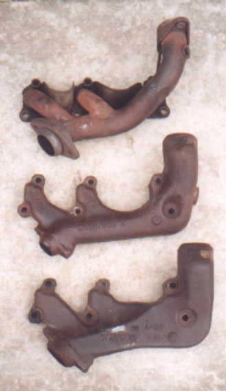

well i finally got my hands on the right exhaust manifold and the up and down pipe however but crossover pipe coming from the left exhaust manifold will not fit the right exhaust manifold..the inlet on the right manifold is smaller than the crossover...what should i do
driver side manifold is smaller than the crossover pipe opening?If that is the case just use a na driver side manifold it has a larger opening.
nope the driver side manifold and the crossover pipe looks maybe like 3" the passenger exhaust manifold where the crossover connects to seems maybe like 1.5 or 2"
let me try to make describe my problem clear...im using a 81 n/a driver side exhaust manifold and n/a crossover pipe however the passenger exhaust turbo manifold where the crossover pipe connects to it..is too small....will i have to get the crossover pipe welded to the turbo exhaust manifold...or will i need the driver side manifold and crossover pipe from a 83, or can i make a adapter so the small turbo exhaust manifold can connect to the larger crossover pipe
I'd make an adapter. The larger size of the crossover will give a good balance for the turbo. Get a small (3-4") piece and make a flange with it and have it welded to the crossover.

cut the na larger hole off the pipe,then get a smaller outlet made to that manifold and get it welded on the the pipe
