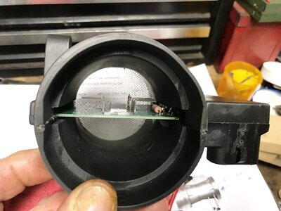

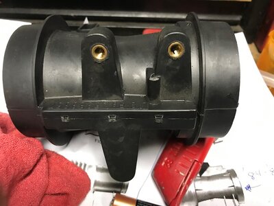

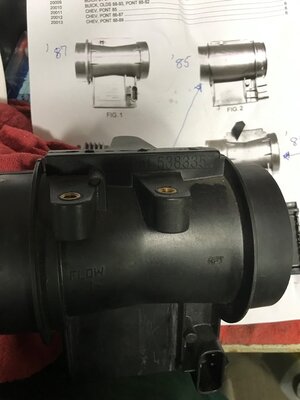

Well Then........Please take a gander at these attached. I think it's OEM for an '87 ? I realize that your running a LT 1 , but some A#@H%^* took this Jerk with a story on this one. :oops: Anyway, I have no use for it & I'd like to help out somebody that does. ;)

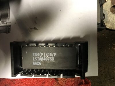

Then.... This last pic below is what came with my setup when I bought her a while back. Any Idea what these #'s & letters decode too ?
Thanks Doctor
Thanks Doctor
Did that MAF off E Bay work out for you ?
aaaah sorry brudda that is not a OEM maf for 87. no idea what those numbers are on that chip ... OEM chips for 86/87's have CMW, ACXA or BBKJ... BBKJ is the recall one in 87 ...
