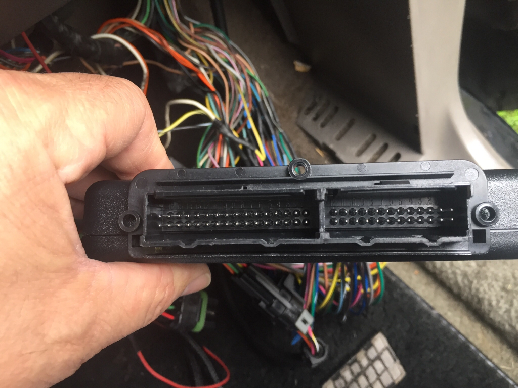

which pin is 28 for the fuel pressure signal to T into.? With the Hartline sticker up facing the box as in the photo. The right plug is smaller and is numbered 1A-12, the left plug is numbered C1-16.
You're looking at the pins on the adaptor harness not the pins on the Sportsman box

Yes should have looked on the back of the Sportsman unit. I'm about ready to start it for the first time is this morning ok to call? Hate to bother you on a Sunday morning.....
