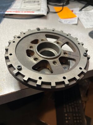

Cruz 12-1 crank trigger on ECUGN

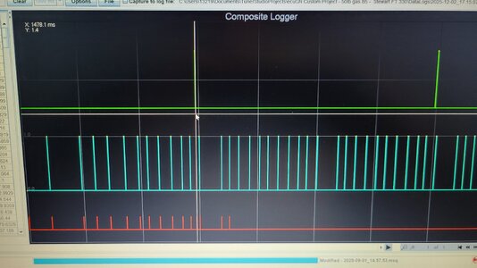

So here's my composite log. Cam sensor is still in the stock position.
The way I read this is that I need to advance the cam sensor about 70 degrees to put it just in front of the #11 magnet. That would mean I need to rotate the cam sensor 35 degrees ccw to put it where it should be.
Am I right..??
Am I right..??
Mark.
Yep that’s right.
You want to be well between 10 & 11. not so close to 11 that there’s a chance of timing chain slop letting it go past 11 where it could end up in the big gap.
When you’re done the VVT angle will be 175-185 degrees when the engine is running. 185 being more advanced than 175.

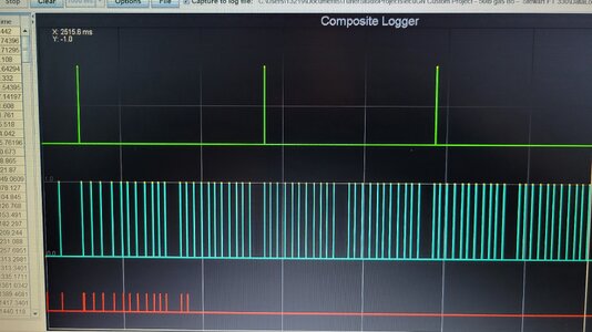

OK, so here's a new composite log with the cam sensor advanced. Its about 10 degrees ahead of the #11 magnet. Look ok.....?
Ready to check the cranking timing, right?
Advance it some more. Move it further away from #11.
Yep, ready to check timing during crank, use zero degrees for checking. Then fire it up and check timing at idle. Force it to 12 degrees since that’s easy to see. Use paint marker on the balancer to make it easy to see too.
The reason it starts up faster is due to not waiting for the stock ignition to sync to the cam signal then turn on the spark output internally in the module. There is no proven benefit to add teeth to the crank signal, as the stage Indy cars used a hub with the cam sensor and 3 teeth cast into it running at 9000 rpm. I ts nice to modernize things but its really not going to make any difference in performance. Yes the stock module is prone to fail and the aftermarkets are junk too, but the factory crank setup is perfectly fine to run, if you eliminate the module.
The Indy system was "State of the art", bleeding edge tech 40 years ago. As was the stock Buick C3I with sequential injection.
Having a 'reasonable' number of teeth makes everything run better. How much better depends on a lot of things but these trigger systems are a definite step in the right direction.

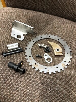

The 12-1 looks like a nice piece. There is also the 18-1 (or 18-2) trigger that presses on in place of the stock 3x and the bolt-on wheel I designed a couple years ago. I'm not sure of the availability of those though but can send info to anyone interested.
My tuner / mechanic used a 36 tooth Ford wheel and Holley pick up for the Holley HP ECU . He liked the Ford wheel because it was the right diameter and he machined it to bolt on .
