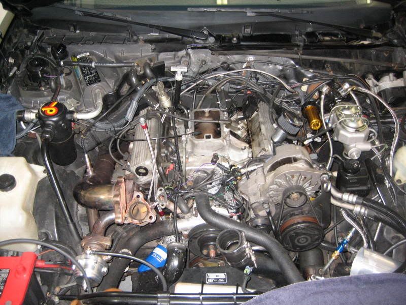

I'll start off with some pics of how the engine bay looked before I tore it down.
