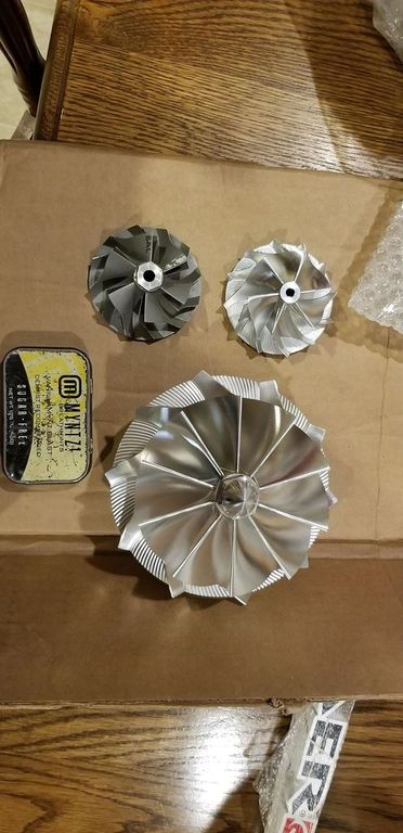

For further illustration of their design differences, here are some photos of some compressor wheels that WORK Turbo sent us, so that we can display them at the Bates car show on Sunday the 3rd.
This photo shows a billet 61.44mm (62mm) compressor wheel, a 62mm cast compressor wheel, and a 122mm billet compressor wheel that can support over 3,000hp (yes, you read that correctly):
The billet 6262 wheel is definitely the way to go!
The newer technology that they implement into the billet wheels really sets them apart from the cast wheels of yesteryear.
Could you please explain the real world advantage to using a billet wheel as opposed to a cast wheel to the turbo layman. I can see the obvious difference in how they look, and have an understanding of they are made.
However I'm unaware what some should expect for the extra cost, specifically on a mostly street driven car. I assume longevity ?
