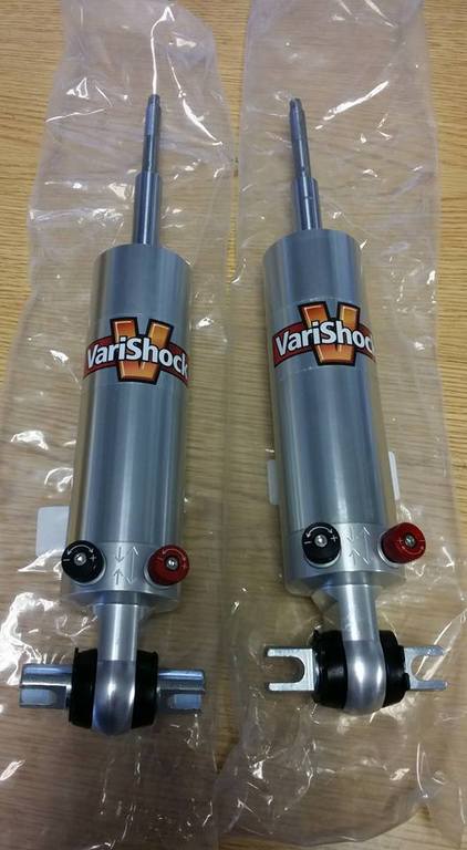

*I have also picked up new Varishock double adjustable shocks from SC&C for the front of the car, replacing the Koni 90/10s I had on there previously.
*The next suspension pieces I am looking to change are the rear shocks to the same Varishock double adjustables, new SPC front lower control arms (mainly because of the ability to adjust the ride height and the improvements on suspension geometry) and potentially a Hellwig tubular front swaybar along with the front frame brace and rear shock tower braces...The bracing and front swaybar are not a top priority, but the rear shocks and front lower CA's are definitely on my list of "wants" and "if I see it come up for a good price used"...

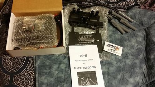

*A New TR-6 ignition, plug wires, mounting plate and coilpack from Don Cruz (great customer service!)

Varishock double-adjustable front shocks:
New TR-6 Ignition with 2-step from Don Cruz. Big thanks to him for hooking it up with hella stickers for my girlfriend's 7yr old who absolutely loved them! He even put some on his Hennessey RC car I got him for his birthday! :D

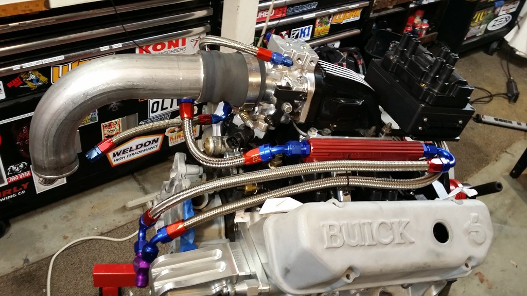

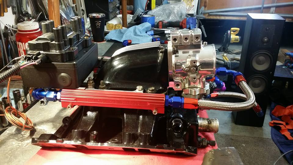

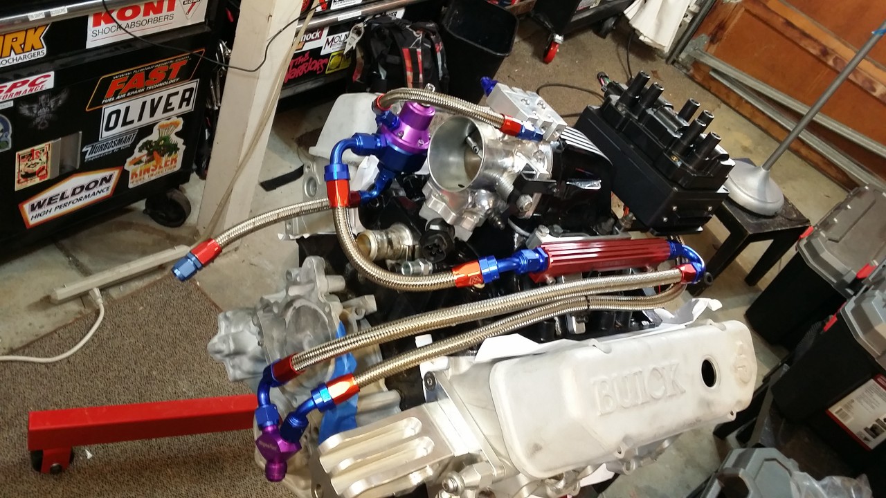

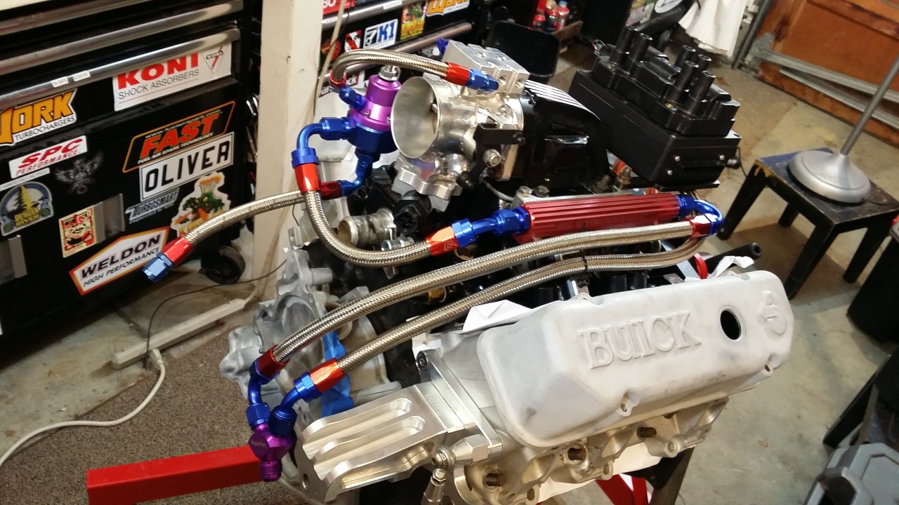

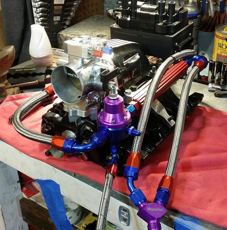

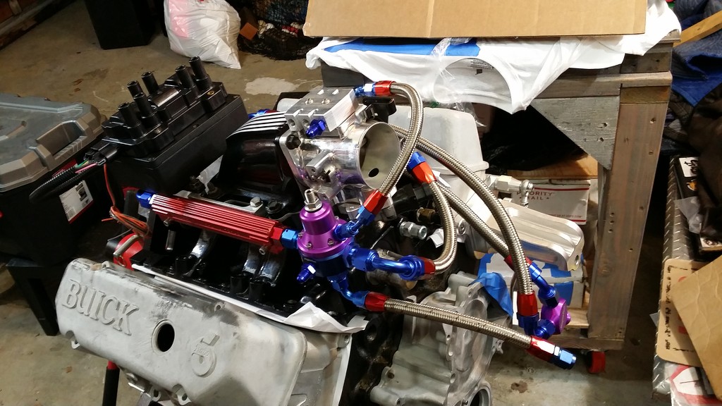

Finally got to pluming the fuel lines with the TR-6 mounted.
Beyond stoked how it came out. "I'm not fucking around"-type setup :D

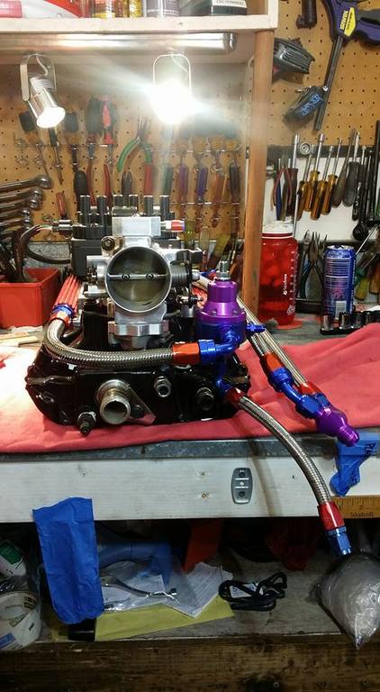

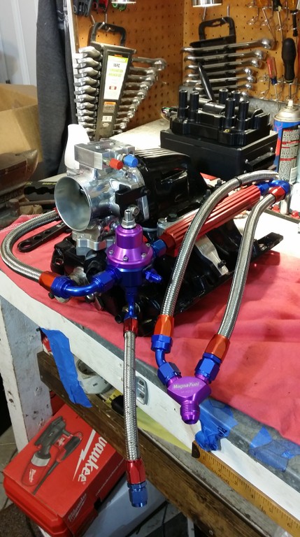

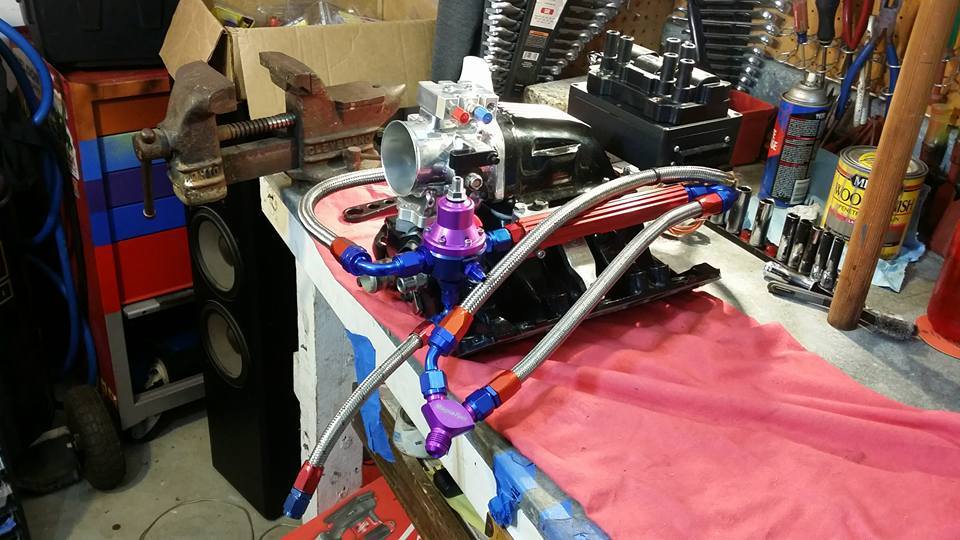

So I brought my old heads home and tried to mock up the motor using my 109 block so that I can try to get a much more accurate idea of how the fuel lines are going to work.
This is the results of me staying up literally all night trying to make the fuel lines work so that there are no obstructions and the fuel lines won't hit anything...
Perfect candidate for our coil near plug setup with Pantera coils
Awesome build! Can't wait to see what it does! I also got a fuel system from Kinsler it's a BA set thanks to Brian and also to Tyler on them helping map out my fuel needs!
