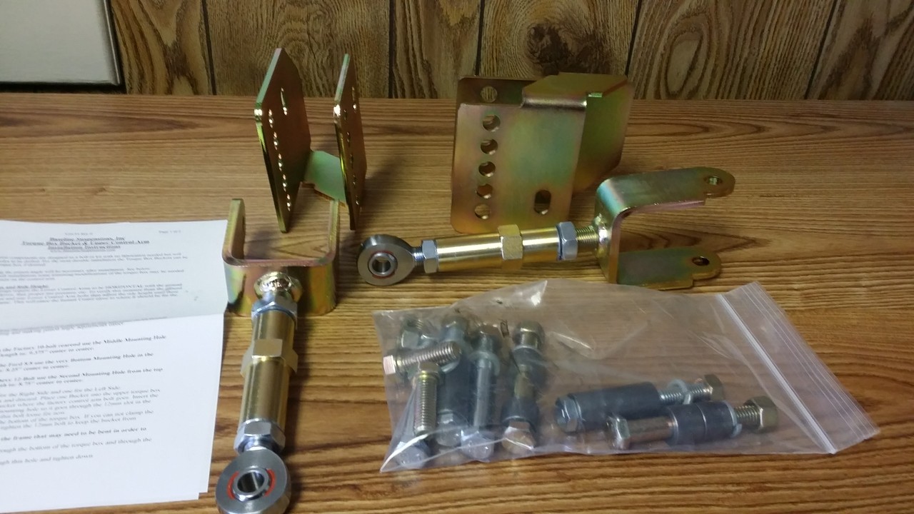

I have been looking everywhere for brackets that would allow you to relocate the rear upper control arm to aid in adjusting the instant center of the car, and it seems Boost Crew Motorsports has them
I believe pacecarta has these on his car and I was looking at using them myself . I think you need to use their upper control arm due to length . I think it needs to be shorter than most , but I'm not sure . This is a link to baselines website with install pictures . http://www.baselinesuspensions.com/kits/chevy.htm

It needs to be 2" shorter. You can also be a supporting Buick dude, and grab them from Boost Crew Motorsports. Ask for Brad or Bo and tell them Tyler Clark sent you :)
(who I will giving my business to) http://boostcrewmotorsports.com/Baseline-Suspension-UCA-Relocation-Race-Kit_p_25.html

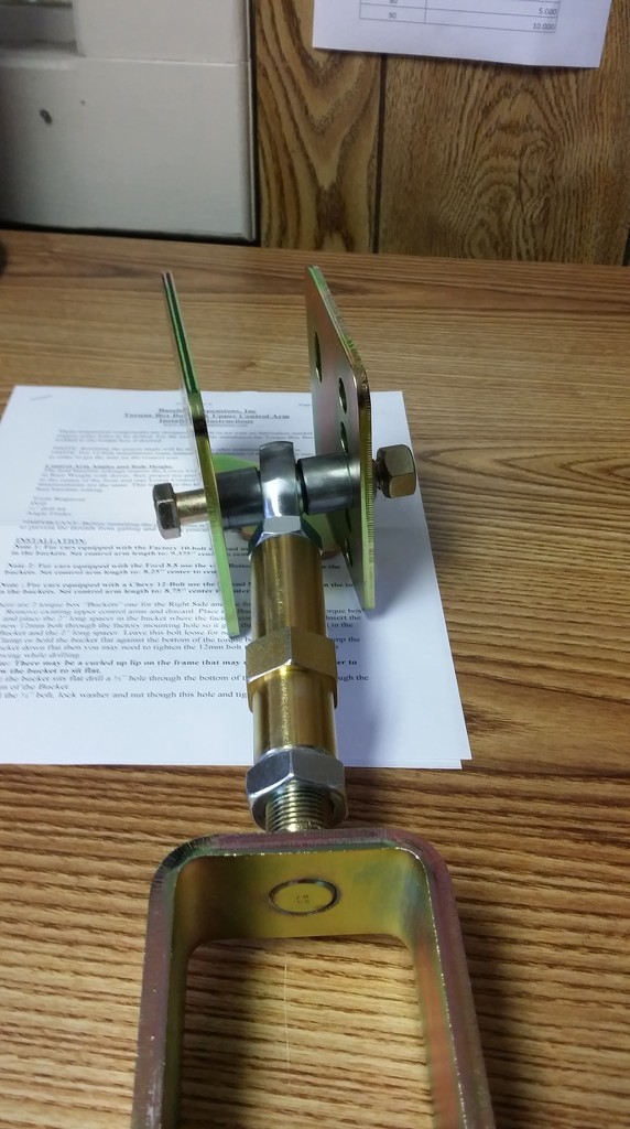

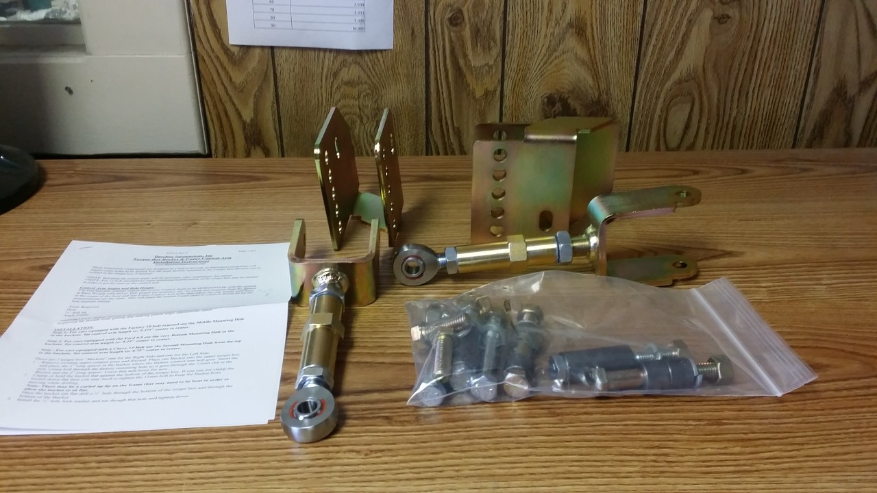

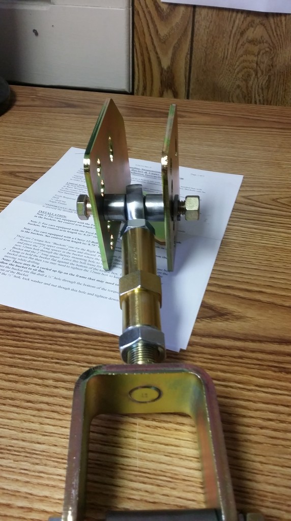

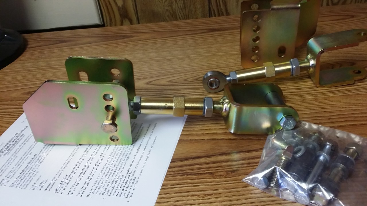

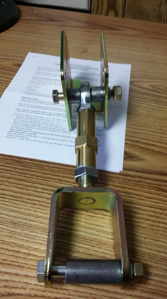

So today I got a sweet package from Boost Crew Motorsports / Baseline Suspension :
New rear double adjustable control arms with relocation brackets that allow you to adjust the Instant Center of your car.
For those that are unfamiliar with the term IC (Instant Center) it is kinda like this imaginary spot in your car that directly impacts how the rear suspension/car as a whole reacts to launches.
For reference, I have attached two scans of pages that outline what the IC is, and how you can calculate it. These are from my personal "Drag Book" that I store all my Buick info in.

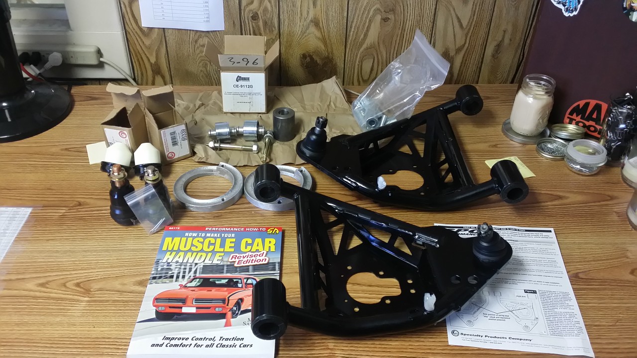

I also got these toys today:
SPC front LCAs :D
