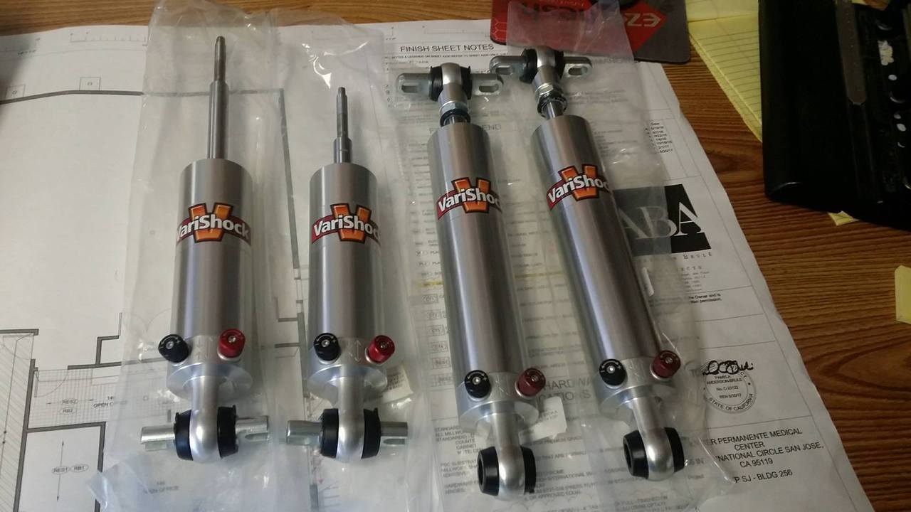

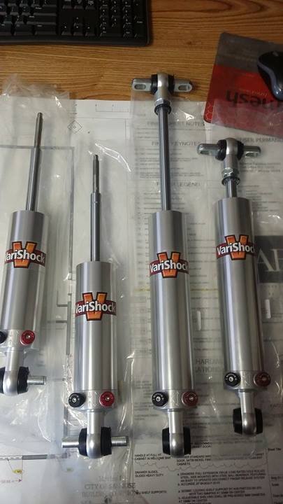

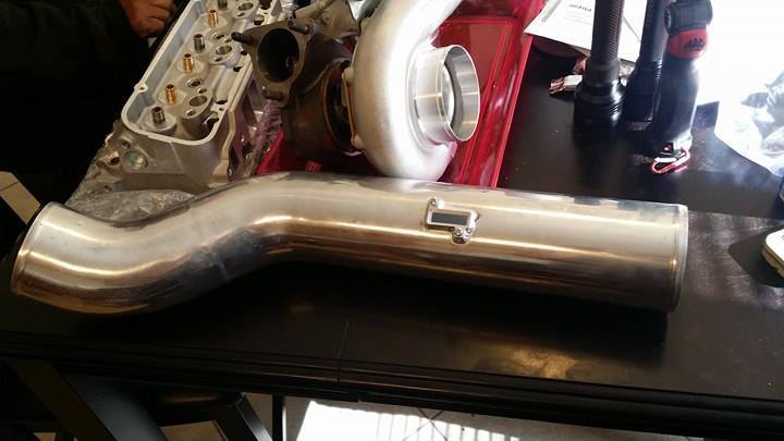

My new Varishock QS2 double adjustable rear shocks came in, and my buddy gave me a 4" MAF pipe that I can use with the new 4" MAF sensor I picked up from Full Throttle today. Really happy to find a nice 4" piece that will allow for great airflow to the turbo with no restrictions.

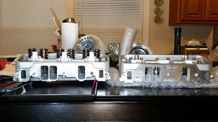

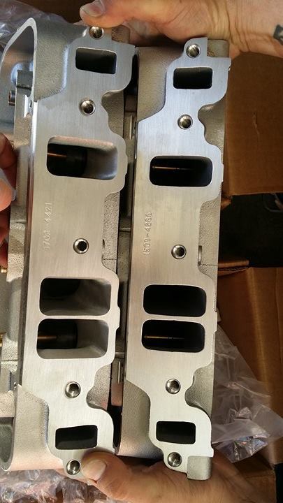

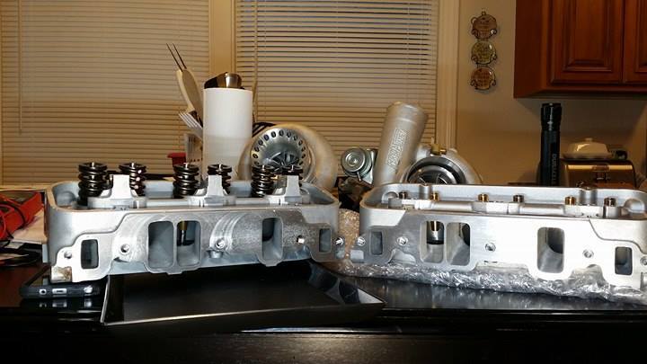

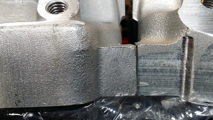

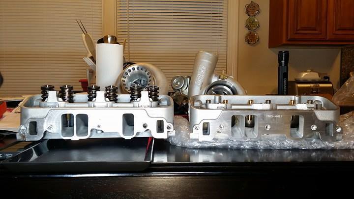

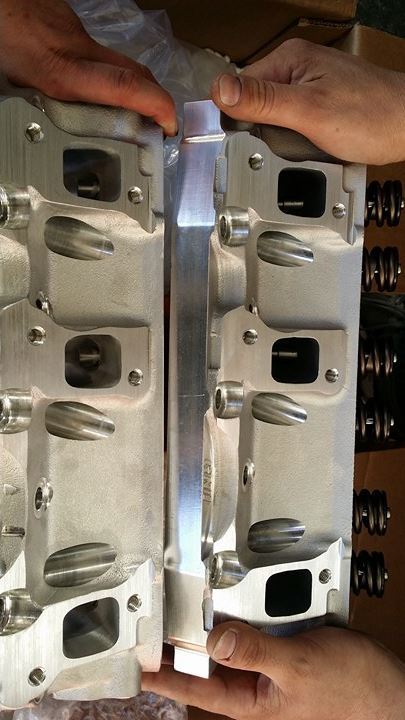

We also got bored and decided to compare some original GN1 heads that were unported with my new fully ported GN1's. Here are some pics for those that would like to see-
Thickness of the decks:
Intake port comparison:
Exhaust ports:

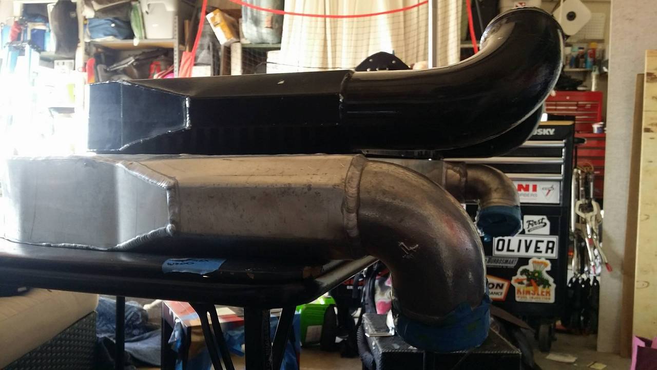

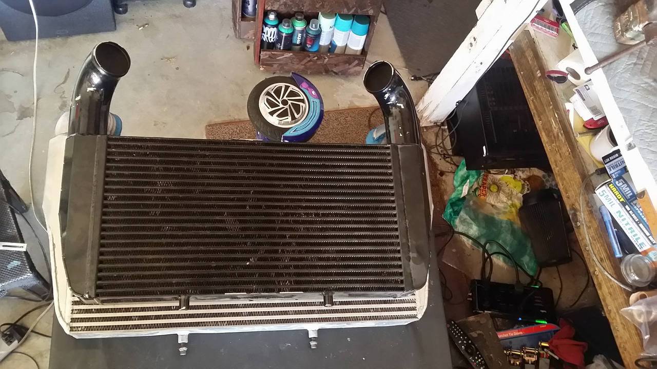

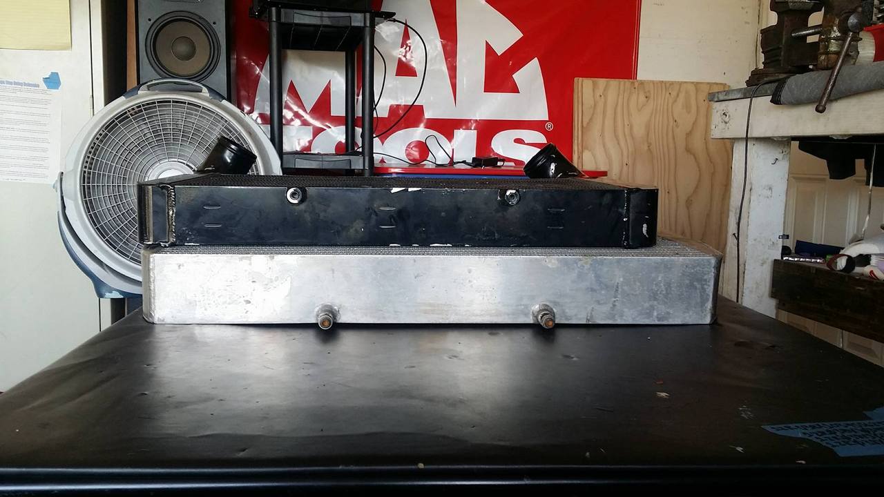

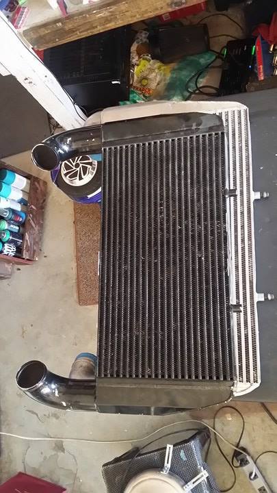

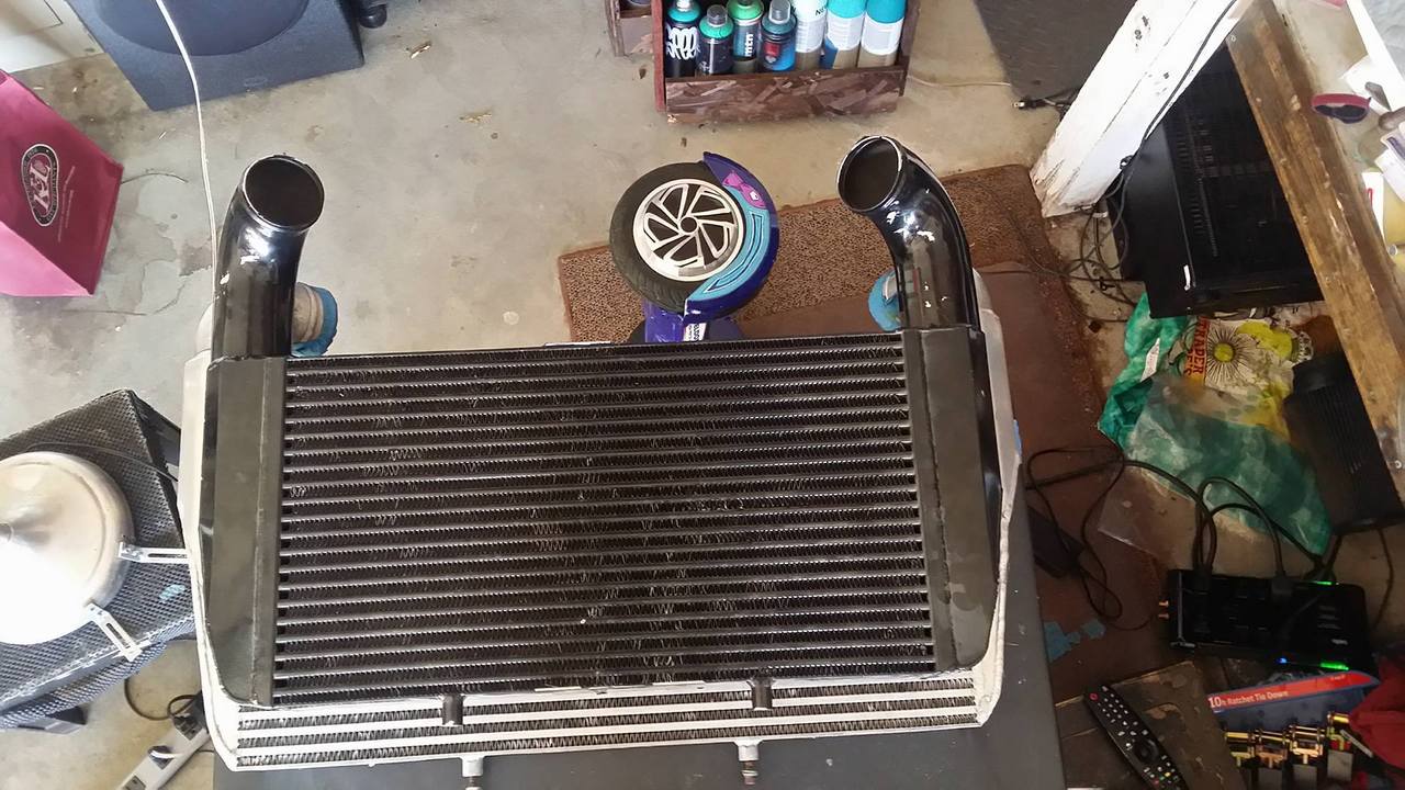

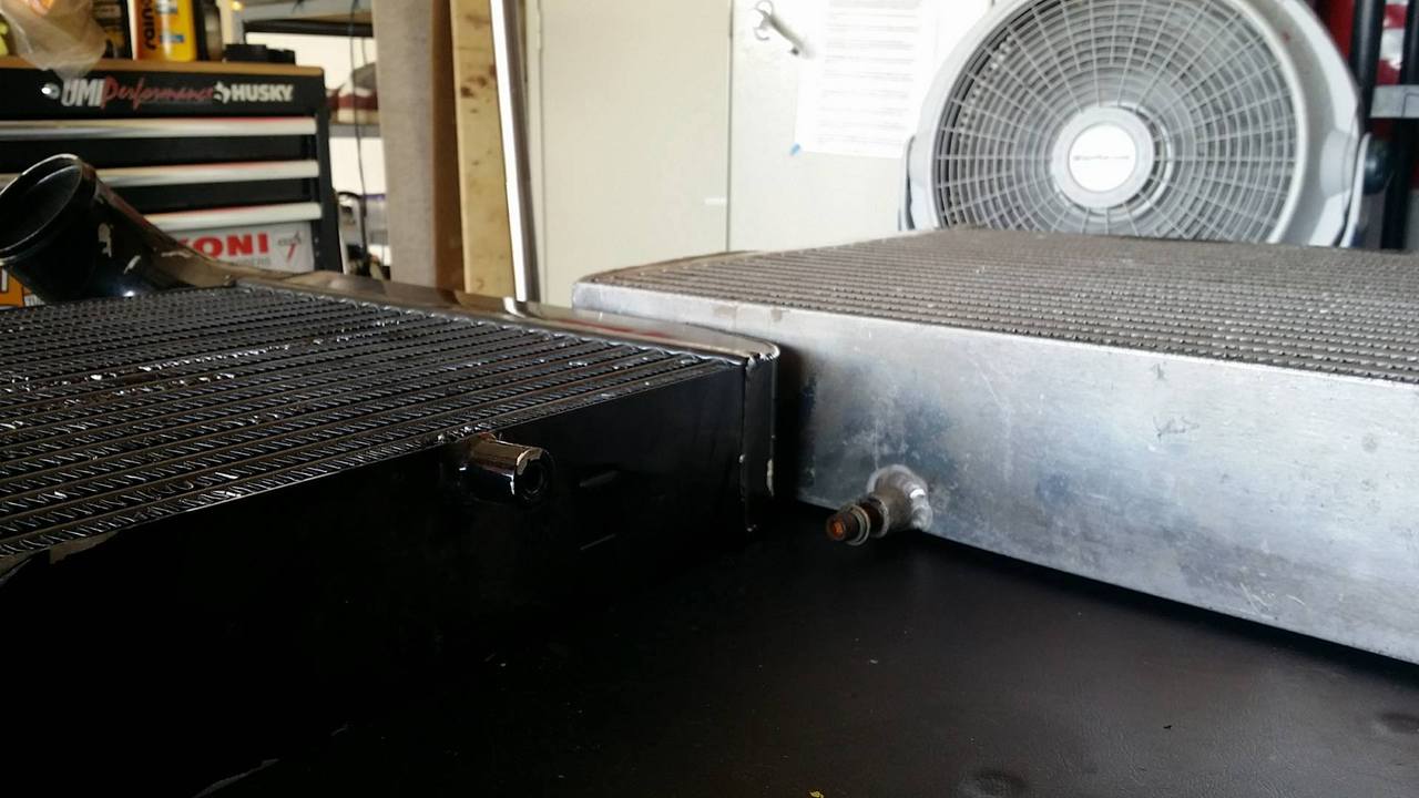

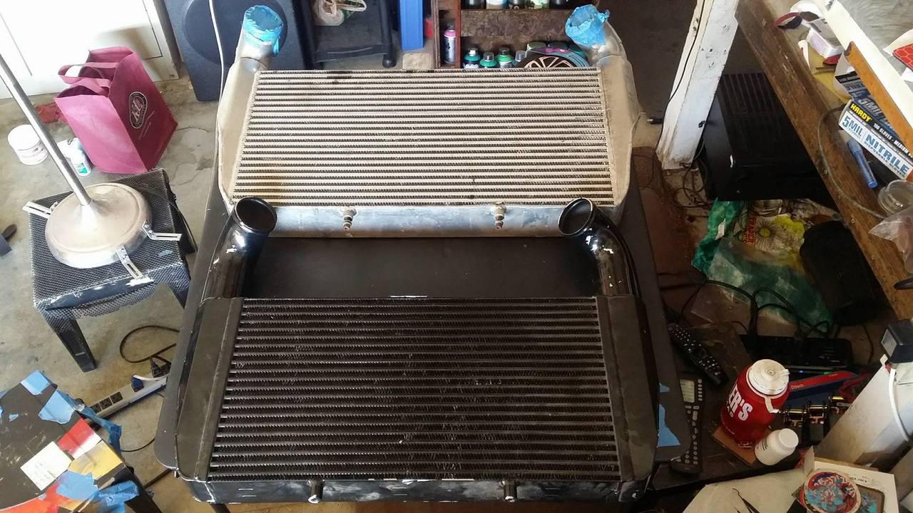

Here are some pics of the new Cotton's FMIC I picked up as well. These are some comparison shots against the Tony DeQuick CAS V2 that I have. Thought you guys might find it interesting to see the difference in size with them next to each other.... and yes, I know you're jealous of my epic coloring skills on my hoverboard :P

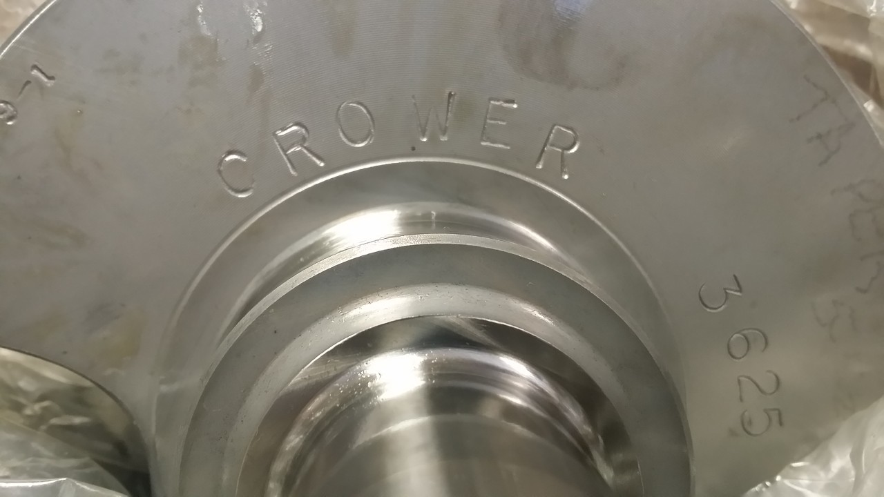

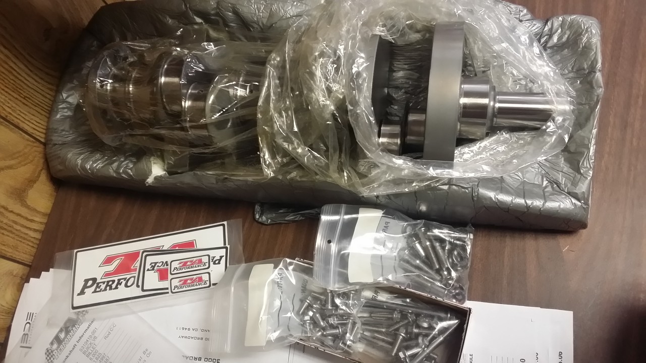

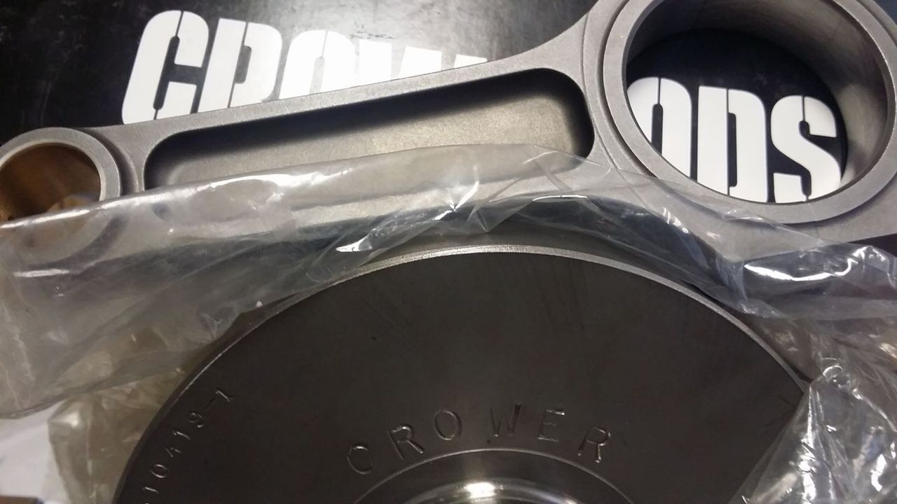

3) My LA Enterprise Billet crank. Wide journal, 3.625 stroke. For those that know, this is one of the baddest cranks ever made for these cars. Second only to the Crower. I am selling this because, well, I have a Crower and I don't need it. Looking for $1,800+shipping/fees OBO.
