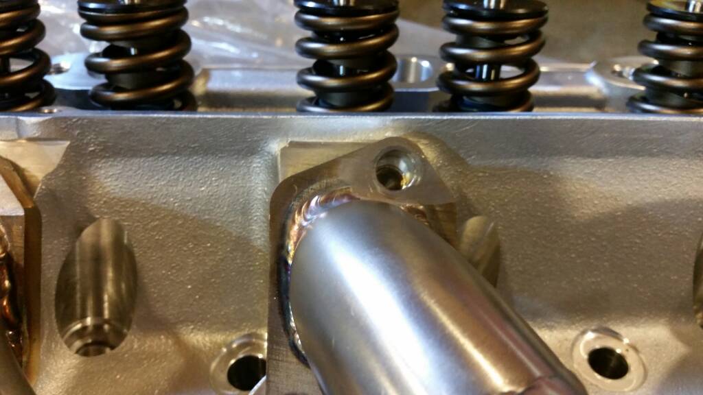

Well this thread got me thinking and I had to go check my headers. I never did anything with them when they shipped to me except take them out of the box to look at them. Drivers side was good. This is the passenger side middle cylinder. Even when I layed a straight edge across the flanges middle cylinder was a strong 1/8" out.
What do you guys think? Think these will bolt up? Was going to have my EGT bungs installed next month.

This makes me think I should go test fit my headers too lol
I got worried also. Hopefully I can get these to work with not to much hassle
